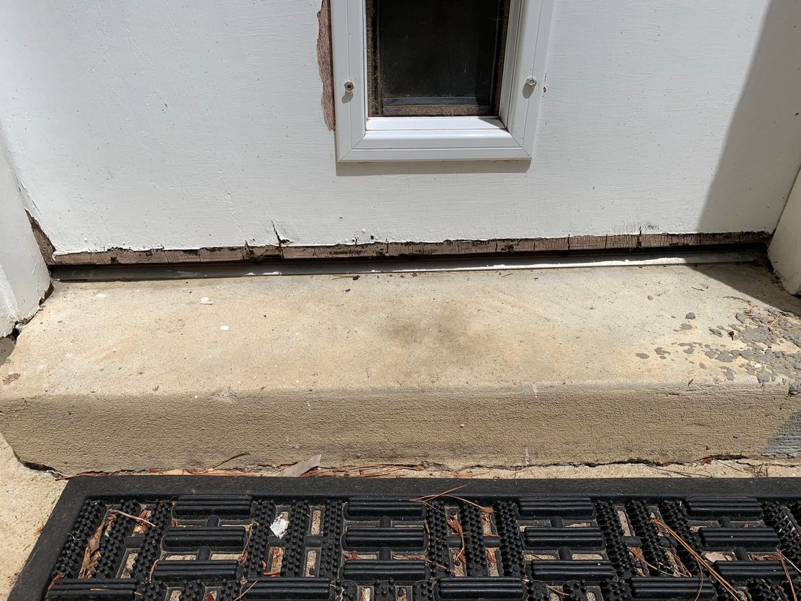

Good Afternoon,
Please see pictures below.
I am planning on painting my laundry door.  No budget to replace it at the moment, but the weather strip at the bottom has come off and the bottom of the door is very weathered and I cannot screw the weather strip back on as the screw holes where it attached are a bit rotten.  Any tips of ideas on how I can re-attached it or suggestions on what to replace it with?  As you can see the gap under the door is quite wide.
Many thanks in advance for any suggestions.

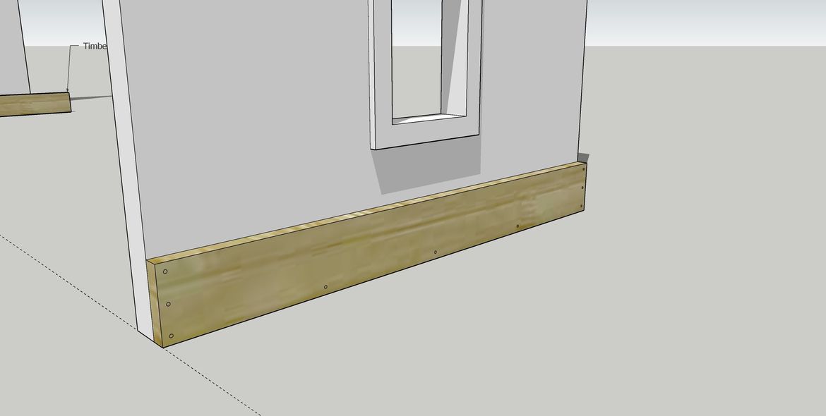

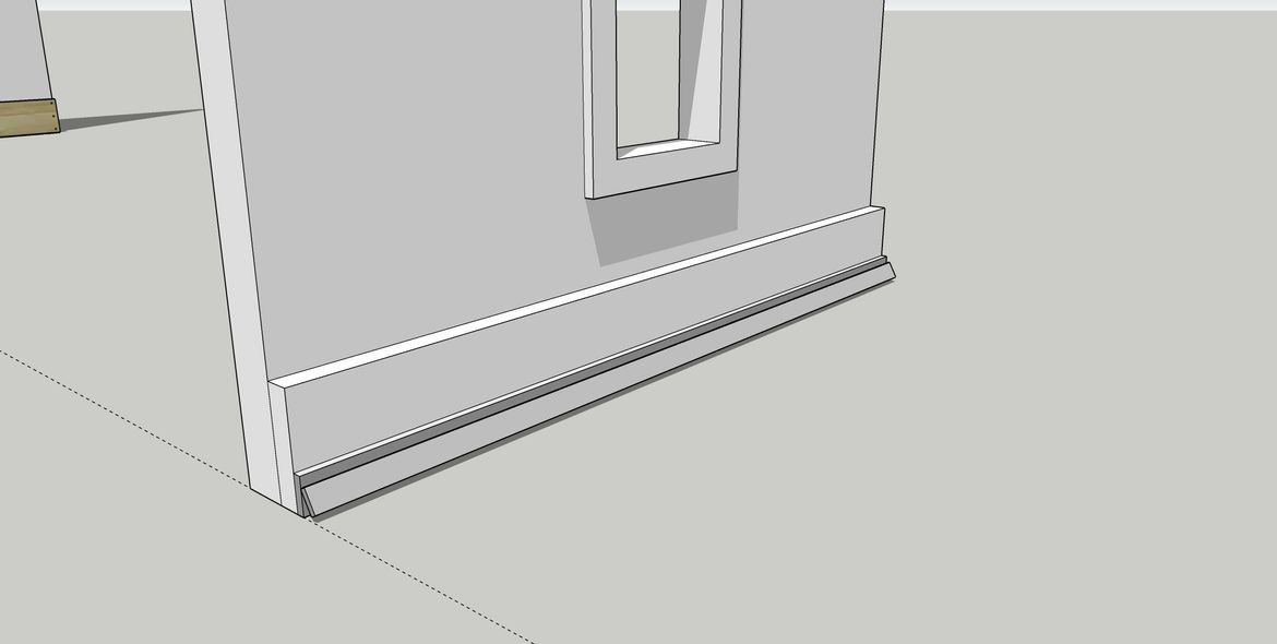

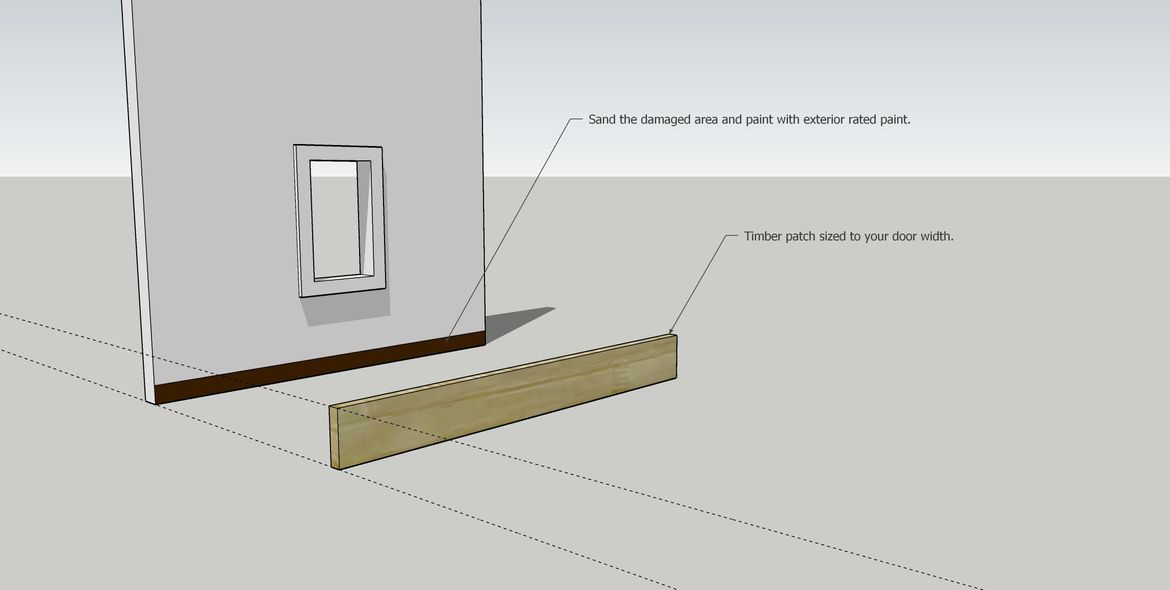

Hello @Sally8
Thank you for sharing your question about how to fix your weatherstrip back onto your door.
If you are currently gathering funds for a door replacement, you can do this interim repair to keep your current door going.
  • Clean the area with a brush and make sure that there is no residual dust left by using a vacuum.
  • Paint the timber panel with the Taubmans Exterior Paint.
Once everything is attached make sure to test that the seal is working correctly. I've placed some images below to give you an idea of how to build it. If you have any other questions, please don't hesitate to post them.
Let me tag our experienced members @JoeAzza and @TedBear for their recommendations.

@Sally8 if funds are currently low, as a quick repair, you can insert timber plugs in the existing screws holes, you could use wooden toothpicks, match sticks or make your own splinter pieces to fit, I usually dip them in a timber glue then tap them into the existing holes in the door, any overhang, trim off with a Stanley knife or similar, then once the glue has dried, sand and fill the area with a suitable exterior timber filler, paint when dry, reinstall the weather strip.
