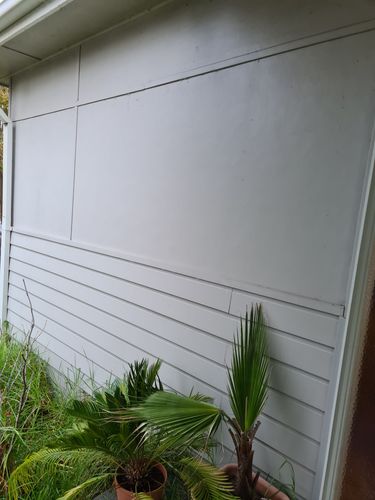

I have purchased a metal gecko that I would like to hang on the outside of my 1950s fibro house. I'll assume the gecko contains iron because it is rusty.
I would like to place spacers behind it to protect the paintwork from rust stains as it will occasionally get rained on.
Photo of gecko and wall follow.
Re: How do I hang lightweight decorative metal artwork to a fibro external wall?
Hello @Echidna
Welcome to the Bunnings Workshop community. It's wonderful to have you join us, and thank you for sharing your question about how to hang your metal artwork.
I suggest using Surface Gard 19 x 19mm Clear Square Rubber Bumpers - 6 Pack on each raised surface of the foot, one on the tail and one on the head. I recommend using Selleys 95g Liquid Nails Fast Grab Construction Adhesive to stick the rubber bumpers to the rusty surface of the metal artwork. I suggest using Zenith 8G x 40mm Stainless Steel Type 17 Decking Screws to hang the artwork in place. Please make sure to drill a pilot hole into the fibro panel.

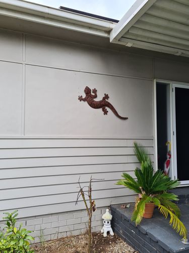

 and here he is, on the wall.
Love your work, @Echidna! It looks like he almost crawled up there himself!
Did you encounter any difficulties whilst installing the artwork, or was it all smooth sailing?
Many thanks for sharing your results.
Hello @Echidna
Thank you very much for sharing that project update. I'm glad my suggestions helped. On initially seeing the photo my first thoughts were how realistic it looked.
