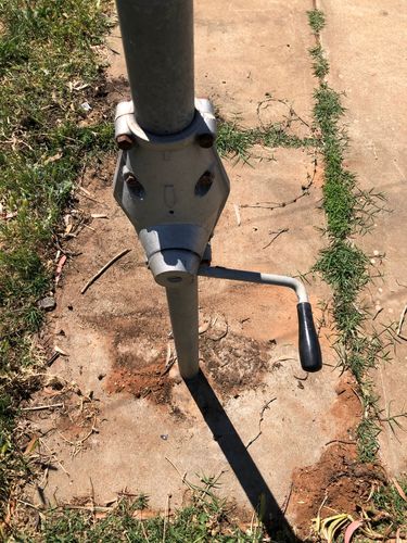

Need to install it again elsewhere in the garden. Should I cut it off at the bottom or remove it with the concrete? And how please?

Ive looked at the clothesline issue so many times over the years and the first question I ask myself "How would I shift it, especially one like yours which looks original!"
Id actually dig it out, then I would smash the concrete off the post as I would be hoping its just a straight post with no protusions on the bottom.
So the steps -
Break up the pathway around the post.
Dig around the clothesline and down (It may be 600mm or 800mm deep)
Then lever it out being careful not to bend the arms.
Hot the edge of the concret "ball" with a sledgehammer and hopefully it will break off.
If you decide to "chop it off" at ground level you will still need to have another piece of pipe welded to it and also will have the post left in the ground.
Both ways require a fair bit of work. Just dpends on how much you liek the clothesline? ![]()

As long as the steel part is well below the ground where someone falling over and driving their knee into the lawn could potentially do, That is an option.
I was think more along the lines if you wanted to reuse the old schooll clothesline (Hills Hoist) by the look of it. Lots of work but depending on what you want it may be in teh range.
And yeah I have considered leaving concrete balls in the ground for some instances (Under my deck is a perfect description and just chop off the old steel posts at ground level) Nowadays I think twice before using concrete ![]()

If I was to conservatively guess the thickness of your concrete slab, it could be anywhere from 75mm to 100mm++ thick plus the concrete foot of your clothesline which could be at least 500mm deep. It will be difficult to break up the concrete surface and the foot of the clothesline. But if you are keen to reuse the clothesline, I suggest hiring a jackhammer to breakup all the concrete.
If you manage to dig around the concrete foot, you could try and lever it out using a Cyclone 1650 x 25mm Hex Fencing Bar. I then suggest digging a new hole for the clothesline and repositioning it there.
The other option is to go with @Dave-1's suggestion and that is to cut the steel pole deep enough so that it does not become a hazard in the garden should anyone fall around it.
