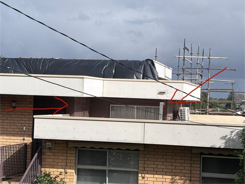

I also want to use the same tiles for cladding a portion of my house as a feature (covering existing cedar cladding that has been painted).

Tiling directly onto steel posts or cladding boards isn't ideal, as you'll struggle to find a tile adhesive that reliably bonds to metal, and timber cladding tends to move and flex with temperature and humidity changes—making it a poor base for tiling.
The best solution in both cases would be to first install fibre cement sheeting. For your steel posts, you can fully clad them with fibre cement boards, screwing the sheets directly into the steel frame. Once that’s done, you’ll have a stable, tile-friendly surface to work with. For the painted cedar cladding, you'd do something similar—screw fibre cement sheets over the existing boards to create a rigid, non-flexing base before applying your tiles.
This approach gives you the solid foundation needed for tile adhesives to work effectively and will give a much longer-lasting result.

Follow up question: Can I also use tile to clad the brown timber portion?  This one looks like timber: (https://www.tfo.com.au/product/natural-brown-ribbed-timber-look-in-out-spanish-porcelain-tile-4953/

Hello @JRJS
The same techniques should be applicable to your other project. My best advice is to silicone the edges of the cement sheet to prevent moisture from entering between the panel.

So I just had a tiler come by to give a quote on using porcelain tiles to clad the steel posts and the cladding feature and he advised that tiling the posts was fine but tiling the outside cladding on the house would result in the glue drying up and tiles falling off in about 5 years or so! I might have to
look at timber look aluminium.
