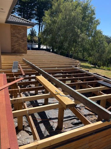

Same as Sarah, I am just building mine and are ready to lie down boards
I have a big deck and would like to do this in 2-3 hits as price for full deck would be a bit hard for me
can I do this way applying all recomended task given here ?
thanks Greg

is there any tip for using Bunnings boards who are plain flat on both sides de is there any advantage to paint/ protect the joists
is that really worst air penetration than boards with grove?
In regard to the boards being plain and flat on both sides @grzes, that’s completely normal for hardwood decking like merbau. You’ll usually only see grooves on the underside of softwood decking, such as treated pine. Those grooves are there to help with moisture movement and drying because softwoods are more prone to holding water and decaying if moisture gets trapped. Hardwood decking doesn’t generally need this, as it’s denser and far more resistant to moisture-related issues.
There is definitely an advantage to protecting the joists, regardless of the type of decking used. Water can sit between the decking boards and the joists, especially in shaded or poorly ventilated areas, and over time that can lead to rot in the joists. Using a joist protector over the tops of the joists helps prevent water from soaking into the timber and can significantly extend the life of the structure underneath.
That said, many decks are built without joist protection and still last a long time, particularly if they have good drainage and airflow. Joist protection is more about long-term durability than it is a strict requirement. If you’re looking to do things once and do them well, it’s a worthwhile addition, but your deck won’t automatically fail without it.
