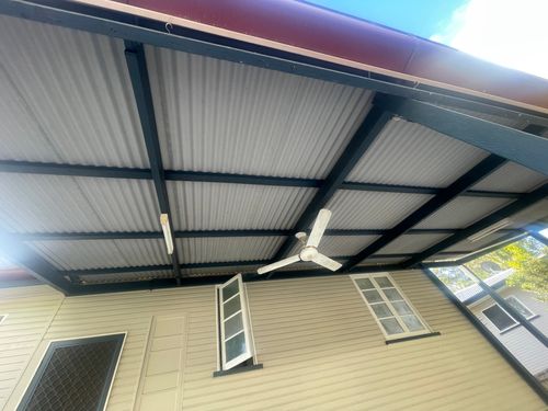

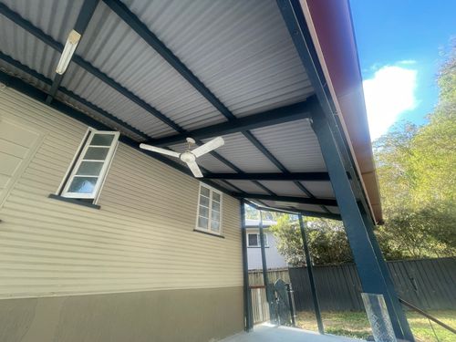

I’m hoping to add a ceiling to my existing patio, however, I have no idea where to start.
The plan is to replace the fans, add downlights (instead of the fluros) and insulate with earthwool (open to other suggestions).
I’ve been looking at James Hardie boards and vj easy craft ceiling panels but not sure if they are acceptable for outdoor use.
Finally, I assume I have to add extra batons as the spaces are between beams is quite wide. Do I just use blue 4x2 pine or something else.
Thanks in advance.

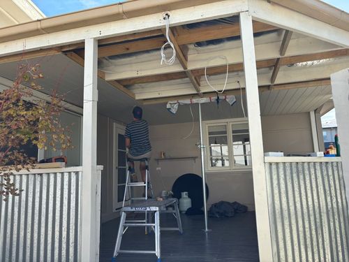

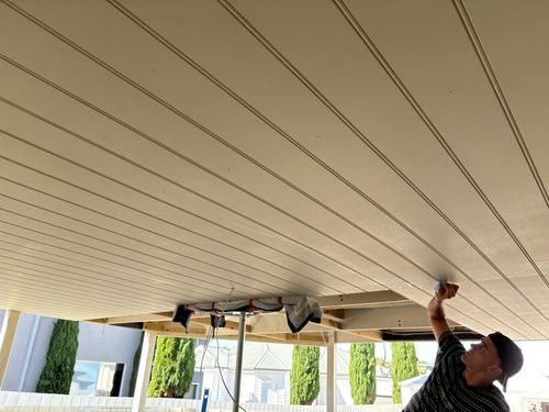

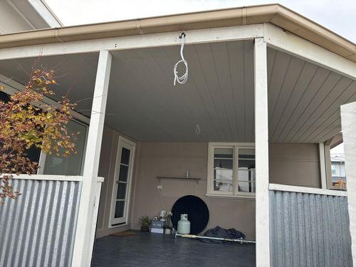

Re: How to add a ceiling to patio?
Hi @Mestry1
It's best in this case not to over-engineer. Don't under-estimate the weight not only of the additional battens, but the sheets themselves which are very heavy all hanging of an original ceiling not engineered to carry the extra weight. Just a centre batten and a shared 45mm one on the ends.
One tip which stuffed me up when installing the battens is that mine started to fall short despite triple checking the measurement of each spacing. What I wasn't aware of is that the sheets my mate bought weren't 2400mm. They were 1205mm. This meant having to double up on way too many battens to have something to fix to.
And yes the sparky needs to rough in once the battens are in.
