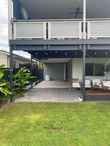

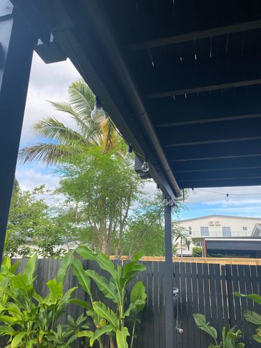

I would like to build a single seat swing to hang underneath our second story deck. My preference is to have the timber seat connected by 4 ropes so the seat is stable but would like it to convert into a single rope each side as it is more comfortable to hold onto. How do connect the rope so that it is not 4 ropes

I thought I'd just add another note to mention that the beam you intend on attaching to was not designed to accommodate the weight and forces involved with a swing. Its job it to hold up the structure above. I'd encourage you to enlist the services of an engineer to assess the beam prior to attaching a swing to it. Better to be on the safe side.
Thank you very much. I will get that reviewed before starting

Bracing for the expected forces on your post would be a good thing to consider. front/back and sideways on the swing as a worst case.
Instead of joining the rope as @MitchellMc suggested you could go down the track of a three hole piece of hardwood timber as the joining point. The small piece stood vertical so the two holes at the bottom to suit your rope are for the chair itself and the hole at the top is to be fastened to the beam above or preferably three branch

You could also distribute the weight of the swing seat across multiple beams by attaching timber across several and then your swing seat to the new beams. The swaying long term is all my concern is.
