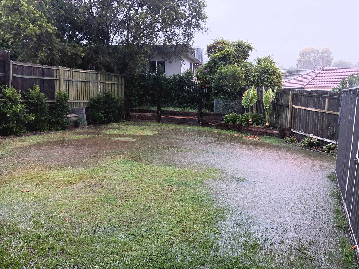

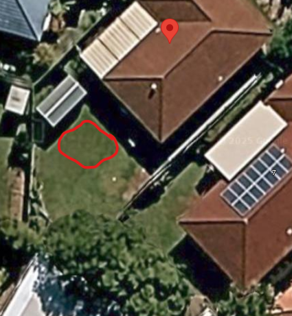

This is an extreme example during flash flooding in QLD but you get the idea. The area in red fills up pretty quick. My street is on a slop and we are midway down the hill so we cop water from the two higher neighbours.

Thank you for sharing that photo. Would you happen to know if your yard has a council drain nearby inside your yard or your backyard is close to a natural concrete drain in a driveway? Installing a French drain would be my suggested solution,
 I understand that you are not prepared for the plumber to come over, I recommend posting the job on Hipages or Airtasker to get a quote for the connection. This will at least give you an idea of how much the service might cost. I would suggest waiting and gathering your resources until such time that you are ready.

Mmm I was thinking at first to fill in the dip with soil over time so the water then wouldnt pool so much, but that really shifts the problem to your neighbours which isnt the best.
Do you know where your stormwtar pipes run on your block is my first question? With the middle of the yard being the pooling point and your house is on a slope I am hoping that the stormwater flows down hill. Do you have any plastic white round inspection points around the yard? Pretty much if you follow your downpipes and then imagine them joining and flowing down to either a service pipe at the rear of your yard you may stumble across one half burried (I am presuming your yard slopes front yard being high and backyard being low)
It may be an idea to get a plumber out to give you a quote on where the imanginary stormwater grill that you would install and would enter your stormwater pipes. That way you have something to work towards and you will know where the stormwatre pipes are. The stormwater pipes should also be listed on the sevices plan of your house (you should have had it when you bought or its available from your council I think) that shows where various pipes travel.
