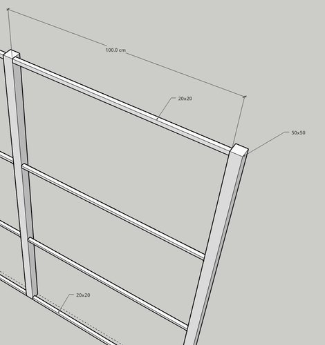

By looking at the Colorbond Good Neighbour fencing panel weight and the load on each post, I thought 50x50 posts spaced every 1m might work.
This the draft i did for the project and this is one repeat of 10m long project
By looking at the guidline for Colorbond Good Neighbour fencing panel weight and the load on each post, I thought 50x50 posts spaced every 1m might work. The top and bottom would be connected by 20x20 beams, and for the middle section, I’m thinking of using this beam:
I would really appreciate it if someone could share their thoughts on this plan—whether it’s too much steel or not strong enough.
