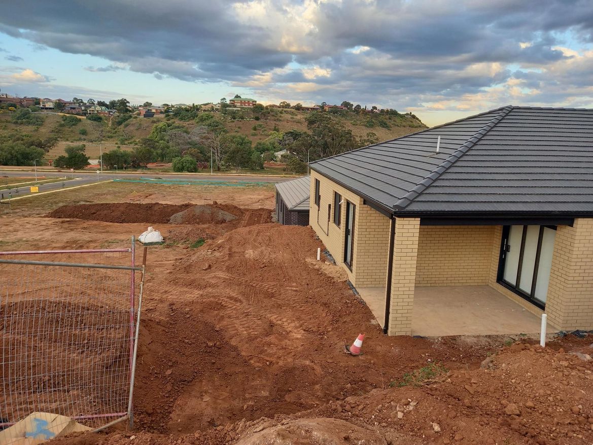

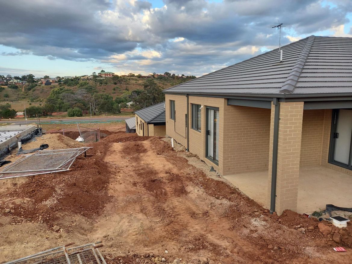

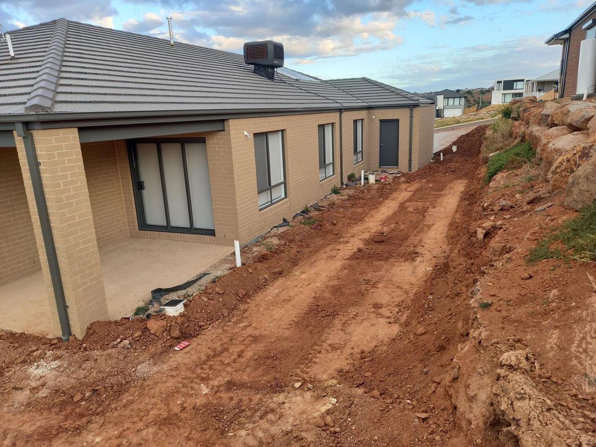

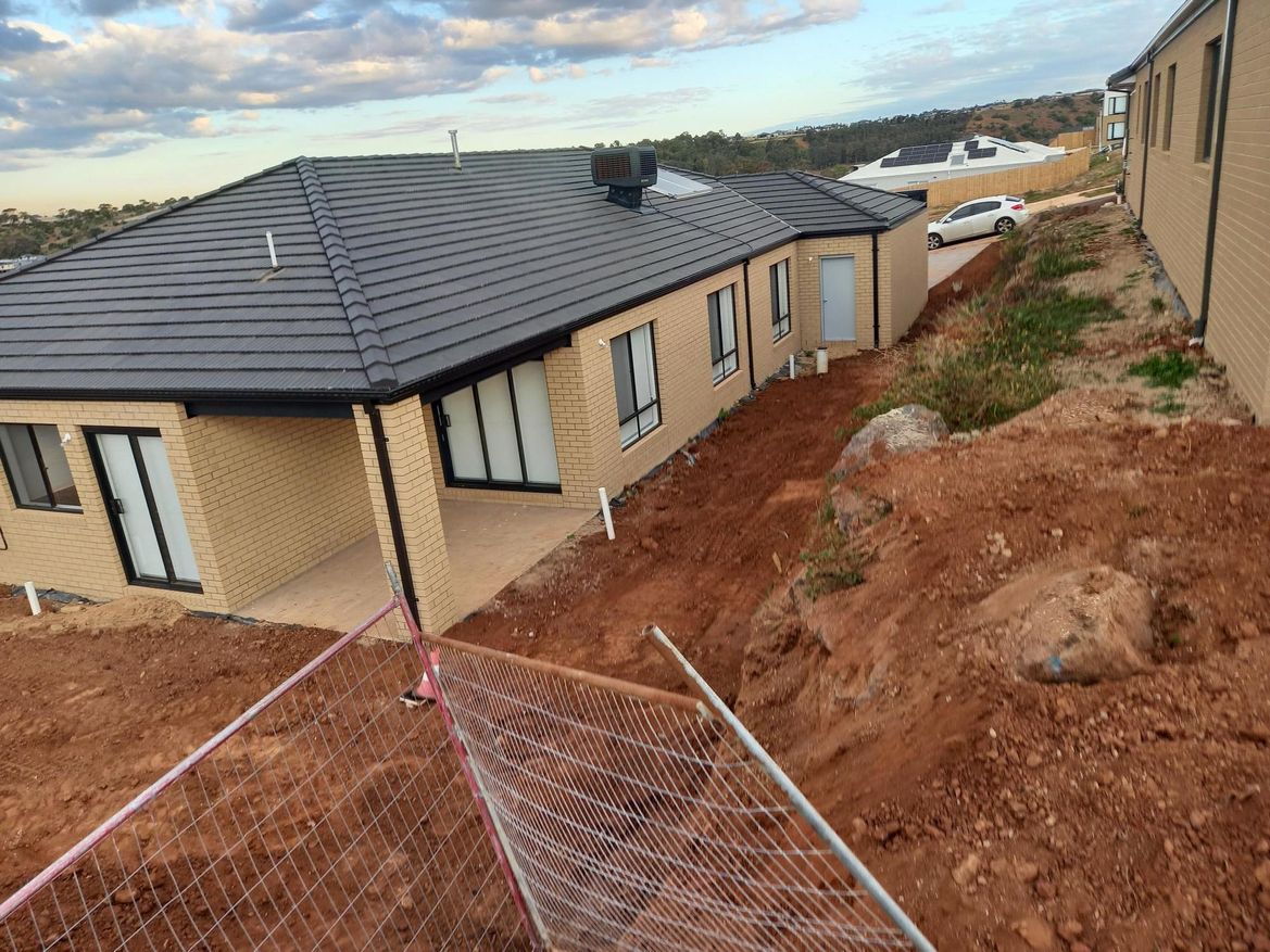

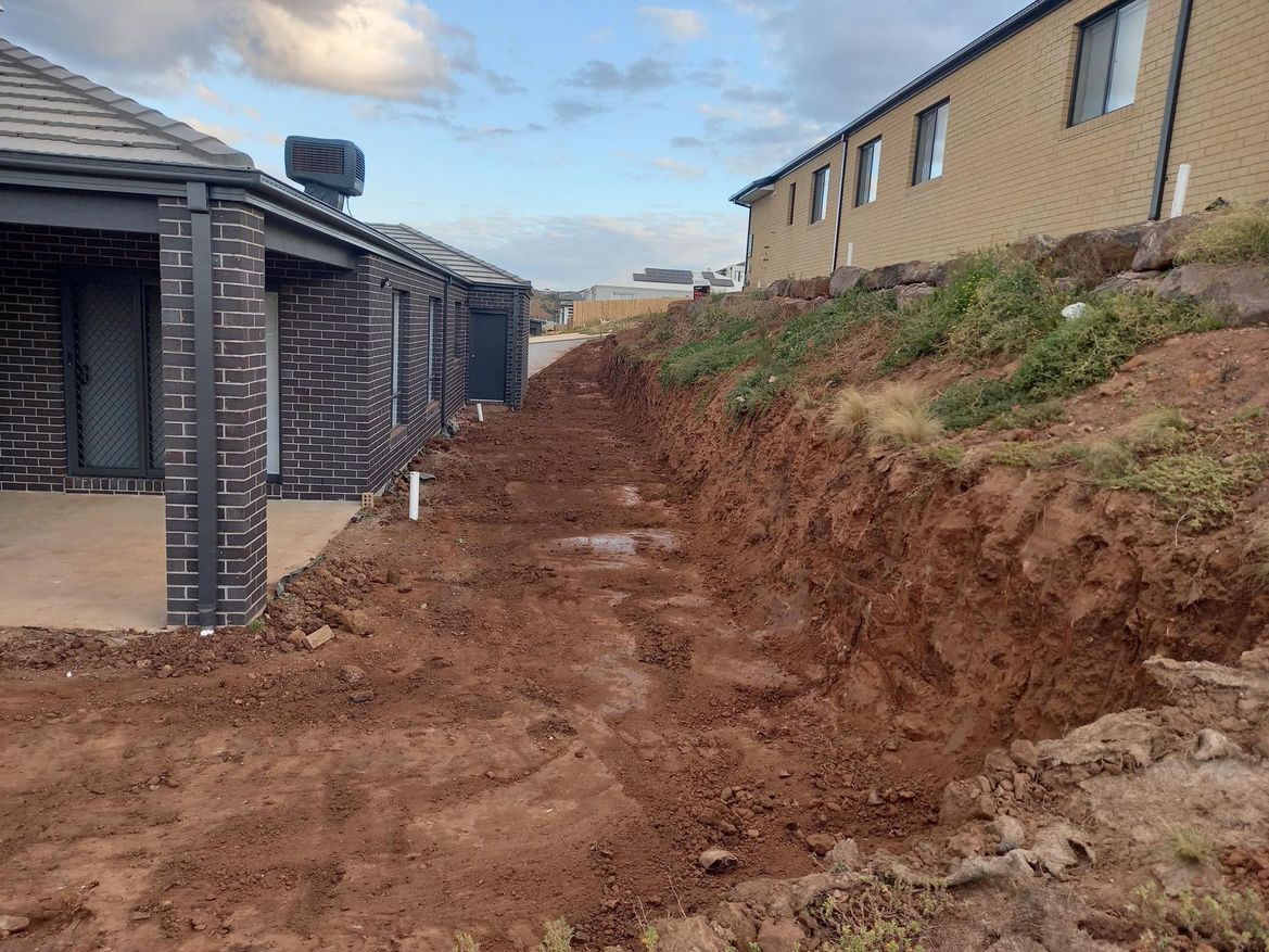

I am a beginner. How I can DIY 1.5m concrete footpath around my house. What tools do i need? etc
It is a new house and currently have no concrete footpath.

There are a few things I would consider before a concrete path.
You will need a retaining wall between your neighbours and yourself, probarly sooner then later as there is nothing holding the soil at the moment. With a retaining wall comes drainage and where you want the water to travel to, wether its towards the road or if there is a stormwater access at the rear of your property.
A fence should also be factored in. I mention these because they may have an impact to your concrete path around the house, with the fall of the concrete and drainage associated with it.

Hi @Modolla1
The first thing thats "urgently" required that @Dave-1 has mentioned is a retaining wall. I am very surprised this wasn't built when the property was graded for the slab as its a substantial height. Once thats in place I would definitely be taking @EricL advice on looking at either concrete or an exposed aggregate done by a professional company. There is a long list of why besides finish quality and strength integrity, but also correct falls for water run off. Additional plumbing will be required which can be discussed with the concreter.
Whichever product you choose it will be expensive. So consider how wide do you actually need for pathways and do you need a space dedicated for your rubbish bins, a space to stand for a clothesline. Factoring in the finish level height of the ground to the desired height of the clothesline itself. And maybe a spot for a garden shed as part of the paved areas.
Something also to consider and can easily do yourself is installing several 60mm PVC plumbing pipes slightly under current ground height that runs from side to side of paths and/or driveway to later feed low-voltage lighting cable or irrigation tubing at a later stage. Once the concrete is down its extremely difficult to run cables tubes underneath if at all without using a specialist machine.
