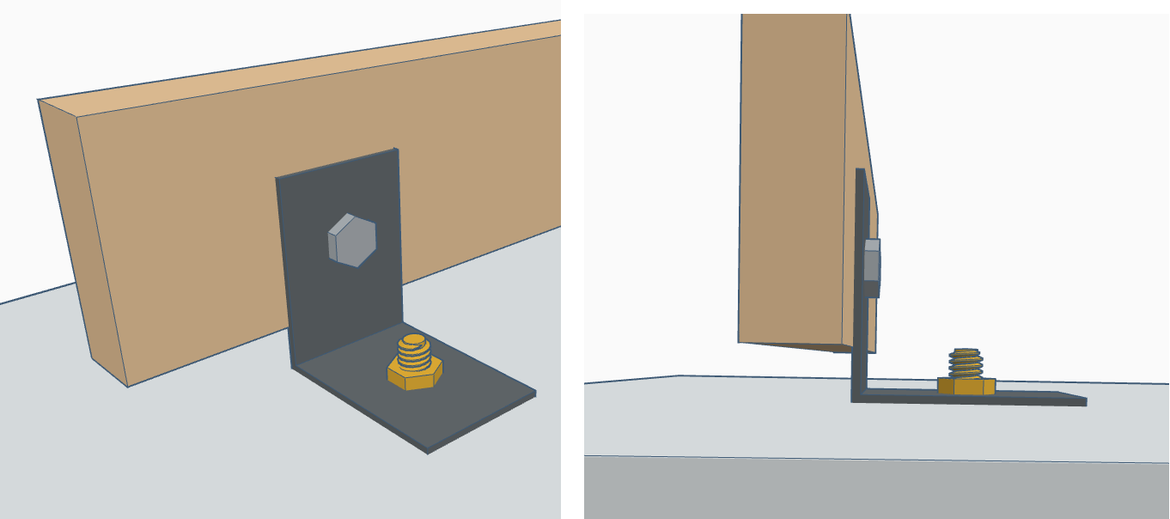

I am going deck in porch my question is how we can attach deck frame to concrete. Do we need angle?
what screws we can use?

I trust the guide provided by @Jason has answered many of your questions, but I'm keen to assist further and encourage you to provide a few more details on your project. It would be great to know how high above the concrete slab you want the frame to sit and if there are any height restrictions you need to work within. Generally, you can use angled brackets connected to the concrete slab with Dynabolts. Coachscrews with a washer on them can be used to fix the bracket to the timber frame. It's always best to leave at least a 10mm gap under the frame to allow water drainage and airflow.
