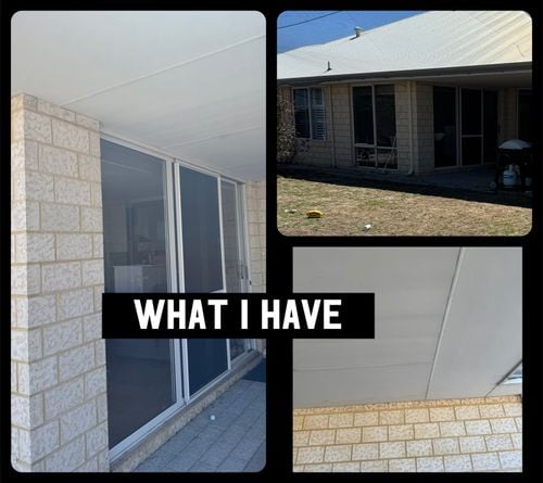

We are ready to start renovating the outdoor area and want to start with the patio ceiling and potentially clad the brick walls.
A clean modern Hamptons look is what we after so ideally a broad cladding that we can then paint white.
We have no idea where to start with the project. Do you have to pull the old ceiling down or can you clad over the top?
Is this a DIY friendly project? We are not totally hopeless but far from expert.
Any advice is welcome….
Some pics of the area & also a couple of inspiration pics but would rather have a flat broader cladding on the bricks.

Hi @Lynne69,
It’s great to hear you’re keen to take on the challenge! Before deciding on a product, the most important thing is ensuring your ceiling has the right structure to support it. Many cladding materials require fixings into timber every 450mm, but if your existing roof structure is spaced at 600mm (which is common), you’d need to add extra timber framing before installation. This step is essential to prevent sagging or failure over time. It’s not just a matter of removing the old ceiling and installing new cladding—it’s likely that structural modifications will be needed first.
If you can check and confirm the existing timber spacing, I can help guide you on whether modifications are required and which product might be best for your situation. This might require removing a sheet of lining to inspect and measure, or you might be able to pinpoint the width between roof timbers by the sheeting fixings.
