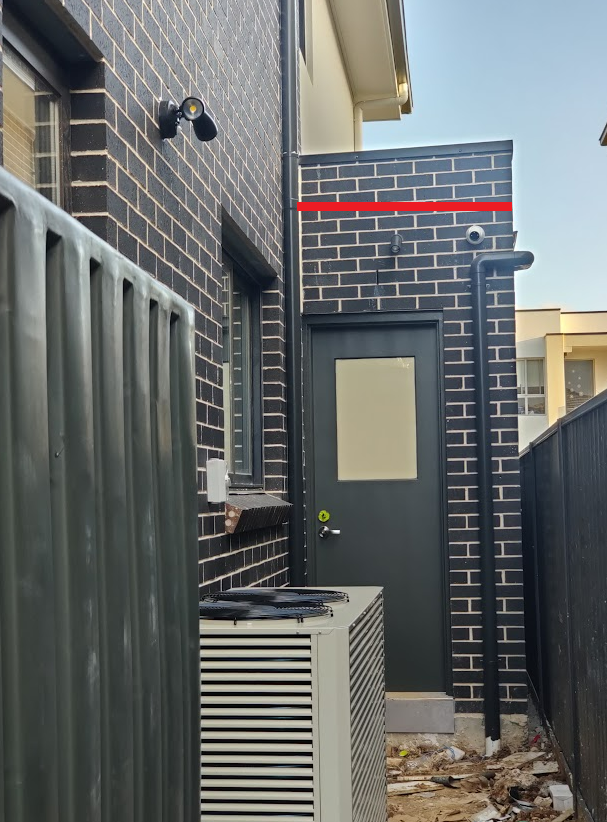

How to protect this Garage back door from weather and rain
Could I add any small roof shade on the marked area or any other suggestions please.
Hi @Samara1,
I apologise for the delay in my reply.
Adding a canopy awning sounds like a great solution. However, it would be best to also add a hinged door seal to the bottom of the door to prevent any water from driving rain that might still land on the threshold and travel under the door. There's also a convenient self-adhesive option that you could easily install yourself.
thanks i have camera & light installed above door top. worrying whether this canopy may disturb these . any thoughts please
Hi @Samara1
I suggest testing the location of the canopy first to make sure that it does not interfere with the cameras line of sight. As long as it does not cover its view of the house it should be perfectly fine to install the canopy. The same goes for the light installed, as long as it does not obscure the light there should be no issue in installing it.
