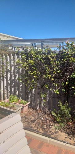

My fence extension is on top of a cement sheet fence it has a metal cap on it do I remove the cap or not ? What do you recommend .  I already have a creeper to grow into it . I'm thinking hardwood lattice but not sure how to fix it

Before you do any work to that fence, I need to point out that there is a very high likelihood that it is asbestos sheeting and should not be disturbed. Please see this guide for dealing with asbestos and the precautions to take around it.
If the fence extension is already in place, I would suggest fixing the lattice directly to its face with Zenith 10G x 40mm Gold Passivated Countersunk Head Metal Screws. Alternatively, if you could take some closer images of the extension channels, we might be able to offer some other solutions.

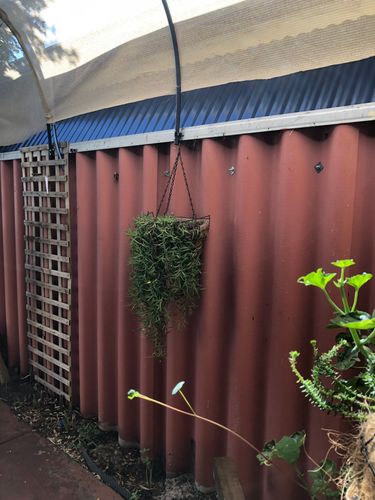

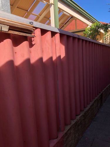

Like @muddy I also want to extend my Hardiflex fence, with plastic lattice. I’ve had them lab tested for asbestos and can confirm they do not contain any. Can you tell me the best (strongest) way to attach an extension? I’d like to screw the lattice directly on to the face of the existing fence, but judging from what I can see of the neighbour’s fixings, I think this would require access to both sides of the fence.

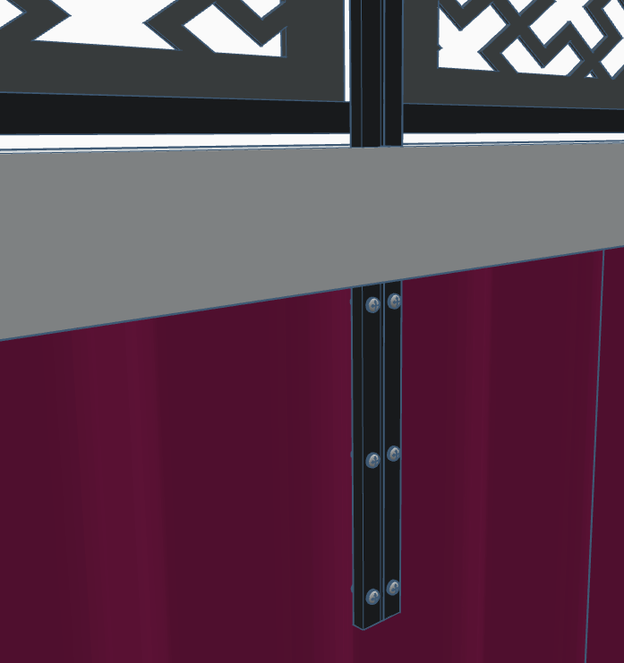

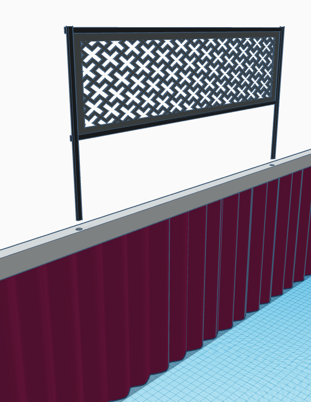

Could you let our helpful members know what type of plastic lattice you intend to fix to the fence? That way, they'll have a better idea of solutions they can suggest. If it's something like the Matrix fence extensions, they are to be used in combination with a frame and legs. The extension legs are what you'll be screwing into the fence. That shouldn't be an issue; you'll need to position your fixings in the profile below the fence's fixings. Do you happen to know what the fence frame is made from?
I think the biggest hurdle you'll need to overcome is the capping on the top. The capping will prevent you from fixing the legs into the troughs of the profile. You could drill corresponding holes through the top of the capping to slide the extension's legs down before fixing them.

For drilling holes in the capping, the fence post is going to be bigger than my drill hole. Do I drill multiple holes around the outside and punch it through, or is there a better way? I’m looking at using a 50x50 galvanised post which would attach to the timber frame on the neighbour’s side.
Re: lattice extension on cement sheet fence
Hi @Louise7,
Do you intend to use a 50mm post with the method I described above? My advice was for placing the Matrix screen legs through the capping as they are quite thin. If you were to cut holes for the 50mm post in the capping, is there enough room for the post to fit within the fence profile? I can't see how that would work, but I might be misinterpreting what you're thinking of doing.
If you need to have larger holes than what you can drill, I'd suggest you start the cutout with a single drill hole and then cut out the section with aviation snips. You can do what you've suggested, but you'll end up with some pretty rough holes.
