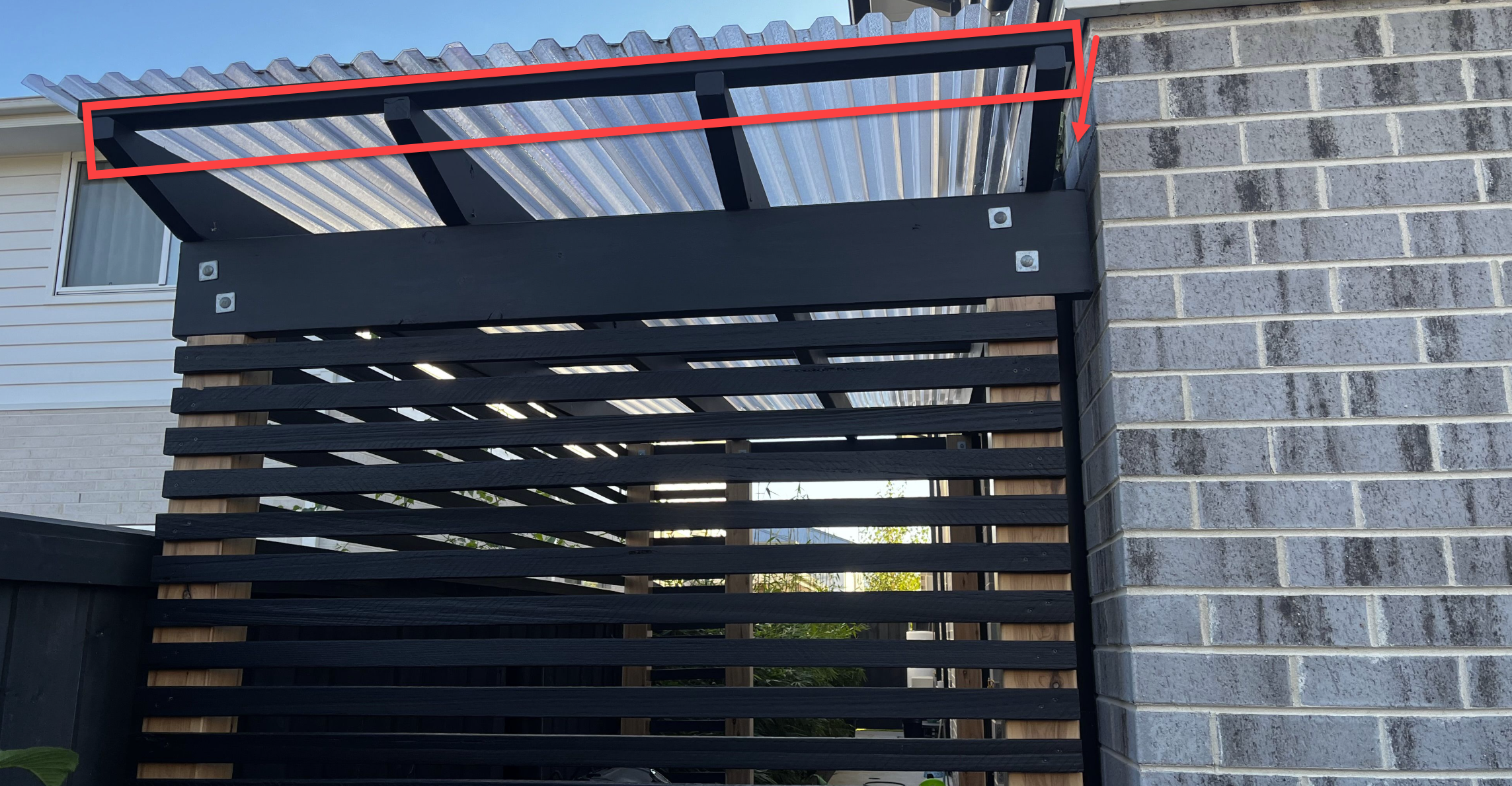

Hi, I’m hoping to get some advice on how best to fit a gutter and spouting onto my pergola and feed into the existing downpipe.
Hi @saffa1,
Thank you for your question about installing a gutter on your pergola.
You'll have to start by installing a fascia board where I have indicated above.
You could then attach your Gutter Clips to the fascia board and hang the gutter with the fall towards the arrow.
You would then have to install a downpipe pop to connect a pipe to route it to the existing downpipe.

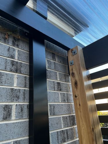

The downpipe looks like a custom powder-coated Steel Downpipe. It could be a Colorbond colour such as Nightsky, but I am not 100% sure.
Unfortunately, steel downpipes are not made with angled connectors like PVC pipe is rather, they are cut and bent on site to fit the requirements. Unless you were confident, I would consider having a roofing plumber connect the downpipes for you.
Allow me to tag @Nailbag and @Dave-1 for their thoughts.
Let me know if you have further questions.

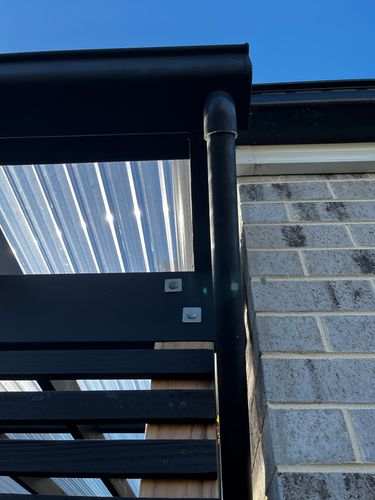

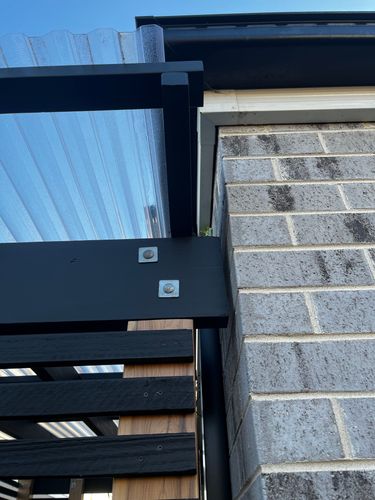

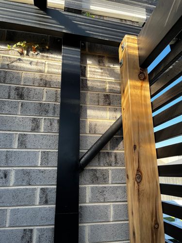

I bit the bullet and had a crack, no facia board I just fastened gutter brackets to the ends of the rafters, had to use a 50mm gutter pop into pvc pipe and then managed to cut a hole for another gutter pop at a 45 into the downpipe without destroying the downpipe lol. Siliconed it all up and bobs your uncle.
from what I could find, don’t need licensed plumber if connecting to storm water above ground.
P.S.
thanks to the knowledgeable customers in store for their advice
Afternoon @saffa1
Nice work and I bet you are waiting for rain! Or have you tested it with a hose? lol
I certainly have tested it with a hose, no leaks which is a relief but the next shower will be the real test.
Hello @saffa1
Thank you very much for the photo update, the gutter and drain looks very well installed.
Please keep us updated with your progress, we look forward to hearing how it performs when the rain comes calling.
