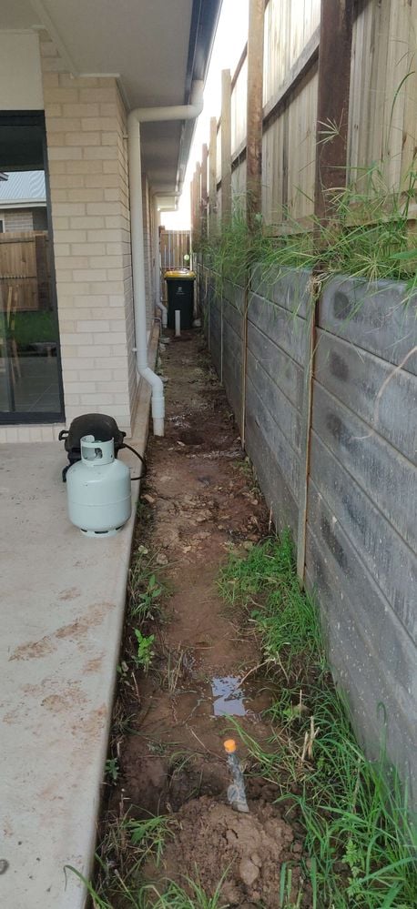

After walking around a bunnings for 2 hours I realised I need some help to come up with a plan to gravel this path down the side of this brand new house I've just moved into. I don't know much about anything landscaping and home owning so I really appreiciate any advice and infomation sources you can link me to. I'm reseraching like mad but it's frustrating. Everyone has different ways of doing things and most information just boils down to "be careful" and/or "just get a professional". I can't afford a professional and I'm not convinced I need one.

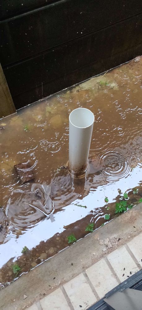

It was going to be straightforward until we had a big downpour and then there was a swimming pool down here. About 3 inches of water just pooled all the way down here. It did drain away after the rain stopped. So it might actually be fine to just cut the pipe, whack a grate on it and start laying down sand/gravel.
But water would still pool up to the top of the drain pipe and a full inch of water down here while it rains can't be good for the slab? Maybe it doesn't matter while it rains, as long as it drains away?

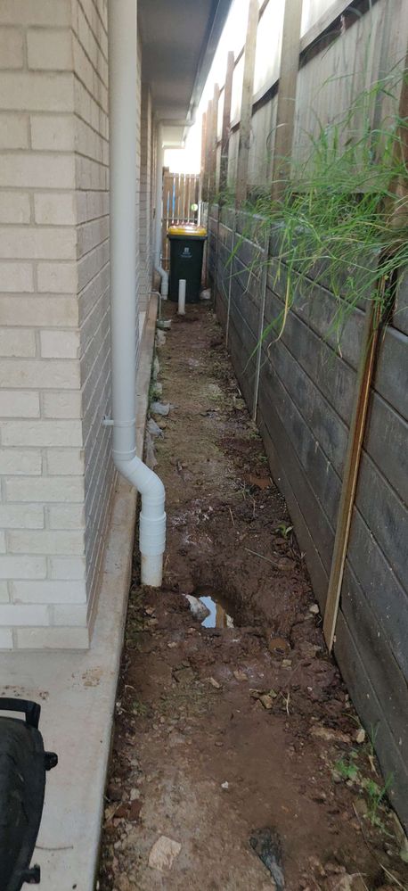

I would've thought it would be agi pipe from the downpipe to the storm water drain just in front of the bin but it appears it's PVC pipe all the way. No pipe along the side of the patio, which did fill with water during the rain.
So what are my options?
I could put two shallow 3-4 meter trenches, one from halfway between the far drain and that downpipe and the other starting from the corner of the patio that slopes towards the downpipe in the photo. I'm not sure if that's a good idea, if it's even nessecary or if it is, how to connect agi pipe to that PVC pipe.
Alternatively - leave the far drain as is. I just do the one trench starting from the end of the patio the photo is taken from, sloping toward the downpipe, might solve a great deal of the problem. Looking at the photos, I might be making a bigger deal out of this than need be. I live alone so I wind myself up often.
I've pretty much convinced myself typing this out that if I just put down something that will guide the water towards that far pipe it would be enough. Probably?

Hi @Troy_
Yes thats alot of water really. Must be coming in from next door run off possibly which you cant stop.
So the simplest way is to dig a 200 deep 200 wide trench To take a 100mm agi pipe with slots .
See the down pipes (storm water) the idea is to tap into them with a Y junction for storm water pipe and add the buried ag pipe and join it with a range of fitting from bunnings search bunnings for agi Pipe.
I would tap into the storm water near the end of the house closest to camera on last photo and make a second T join so the agi pipe collects water from 2 directions from besides the house and from further into backyard too.
So dig 200 x 200mm put a layer of blue metal stones or other 20mm thick base then lay the pipe on top of stones and connect plumbing then fill with same blue metal so any water goes down the trench into pipe and away.
You could use a 65mm agi pipe and or a agi with a material sock on it to stop dirt blocking it in years to come.
Hope this makes some sort of sense if not please ask questions.

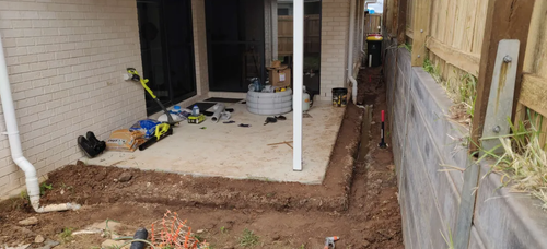

I've resigned to digging a pair of trenches in an L shape around the patio and attaching two snap on connectors into the downpipe drains. Note the DP indicators on photo.
I will check out the rock along the side today, I'm not sure I'm capable to breaking through all that rock and/or concrete. Maybe that's why it filled with water so quick. If it's not soil and it's all concrete bits and rock it won't absorb water.

Progress update.
After digging a trench and fishing water out of the trench for 3 days because, of course, it rained. I bought a pump to pump it out, which worked but it filled back up with water from the retaining wall side pretty quick. I thought I would have more time before it was full again.
edit: the trench stops where it does because the next several meters is pure concrete chunks. Which isn't impossible to get through but I'd like to finish this project and get back to my life at some point. I can add another trench system on the other side of the concrete, surely it's no big deal.
I think I need to wait for the ground to dry out. No big deal.

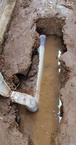

However I've run into another problem. That pipe you are looking at goes to the road. So I would assume it would slope towards the road but if you look closely you'll notice the water line is slanted down the pipe the WRONG WAY.
Didn't need a level to figure that out but here it is:
I could fill in a portion of this trench and make it way shorter, connect it to the top of the pipe because it likely isn't badly sloped enough that the water can't get out. Maybe half a pipe worth of water pools down this end and if the agi pipe pours in the top, it will still flow away. It seems like connecting a trench drain to a pipe sloping the wrong way will just back up the trench drain. It's pointless I would think.
OR my cranky and confused brain wants to fill in this side and ignore it. I could reverse the slope of the majority of the trench back towards the other downpipe, connect the whole thing down there and just call it a day. At least the portion around the alfresco won't flood and surely the extra drainage up this end will help water run out of the side of the house. I can put in another short trench drain down the other end of that side of the house.
I don't know if the builder's going to accept this as a defect and help me or what I could do or do I call a plumber now?
I better not make any decisions or doing anything right now. Maybe it's salvagable I just need some advice.

I'm reading advice stating I should never connect ag pipes to stormwater drains. Starting to think these trenches will just help water pool near the house.
Current thinking is I should fill in these trenches, fill in the low parts around the alfresco and the side of the house, add the grates and call it. This is a problem fundamental to these flat retained blocks. It comes off my neighbors yard (which isn't built yet, so once it is it should direct the water to the gutter somewhat) and gets stuck. It will sink into the soil slowly on that side and run off easily on the south side creating a wet side and a dry side.
Doesn't seem solvable by some dude with a shovel and an ag pipe. I'm in over my head here. I'm glad I found this out before I cut into my stormwater pipes.
