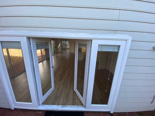

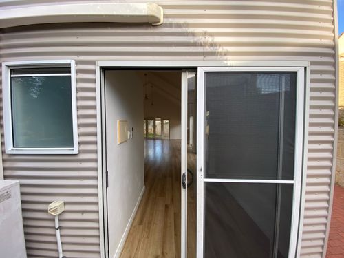

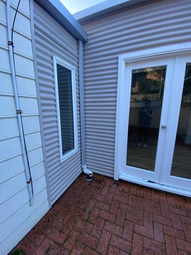

I am uploading the images. We are looking at putting canopies over 3 lots of doors, primarily to protect them from water damage. Not great photos as I am not at the property at present but hopefully you can see what we are trying to do

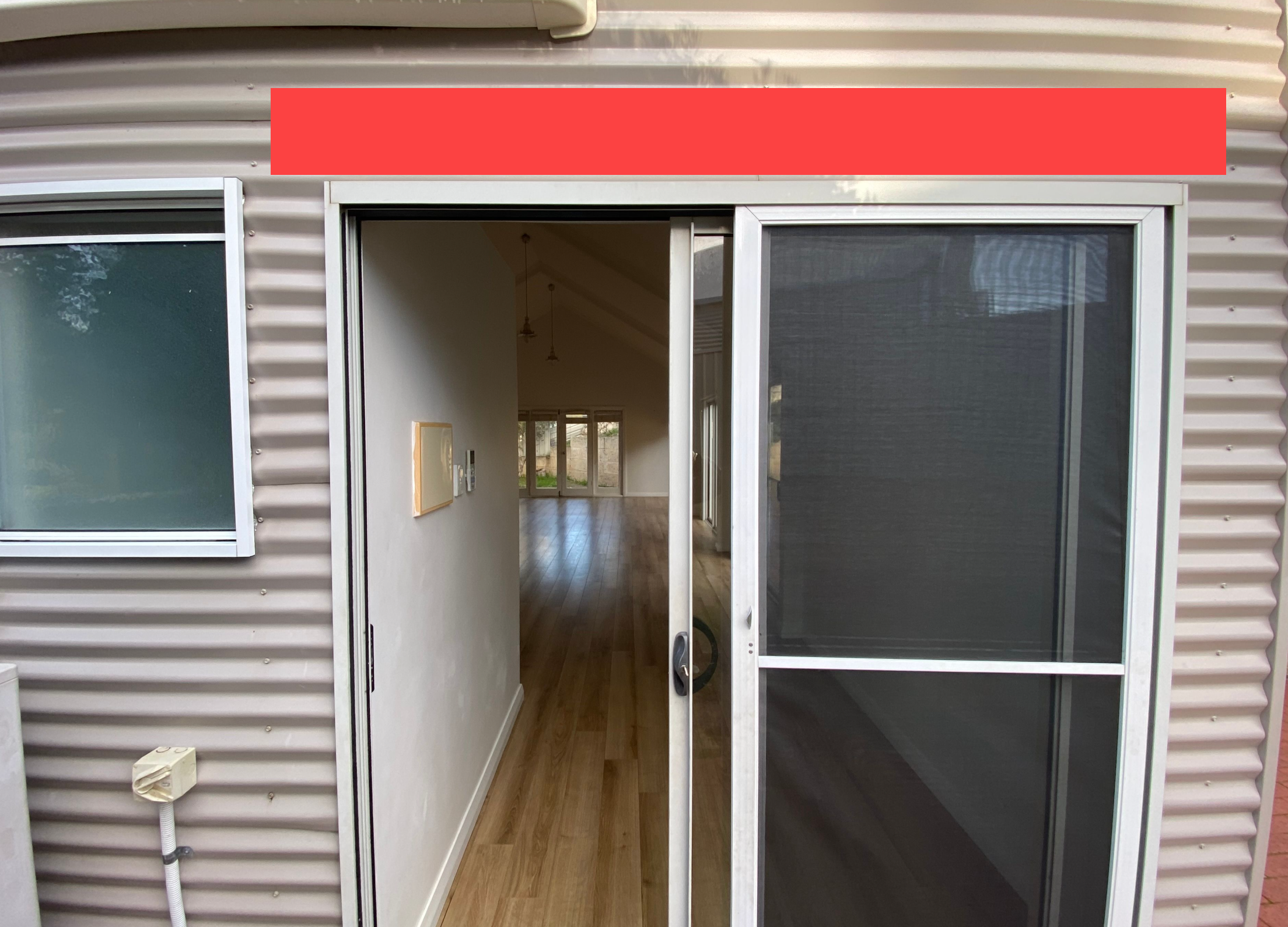

Re: window canopy
Hi @krogk,
Thank you for the photos.
Yeah, you shouldn't have any trouble finding some framing to screw into. With openings of that size, there's a good chance there is a timber header that runs the full length over the top of the doors that could be screwed into. See below for the likely location.
You should be able to confirm the location of a header or the framework with a studfinder.
Outside of this, it would just be a case of following the canopy manufacturer's recommendations for install.
