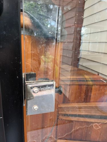

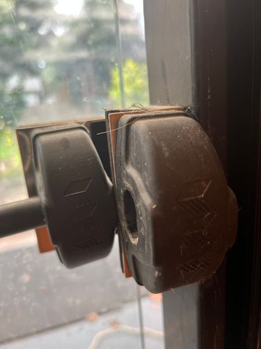

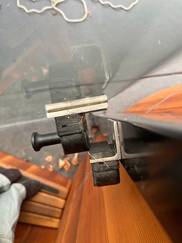

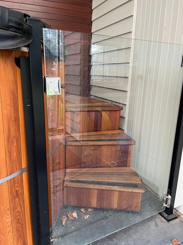

Thanks Mitchell here are some photos would appreciate your thoughts. Kelly
Re: pool gate afjusmtnet
If you push the top of the hinge side post outwards away from the latch side, does it resolve the issue @Kelly5? If so, the simplest solution might be to attach a bracket to the wall, push the post back to the upright position and then screw it to the bracket. Fixing the top of the post to the wall so it's perpendicular to the ground should eliminate the issue. I suspect the post is bending over from the weight of the glass panel.
No unfortunately it is attached to a solid wall
So that post is connected to the wall at the top where I've placed the red arrow @Kelly5? If so, I'm unsure how the gate would have dropped out of alignment. Normally, the gate's weight causes the post to bend slightly, dropping the latch side of the gate down. But, if the post is perfectly upright and fixed in position, the only other thing I can think of would be the gate hinges that have shifted.
You could potentially lower the latch mechanism of the post next to the spa to align with the new position of the gate.
