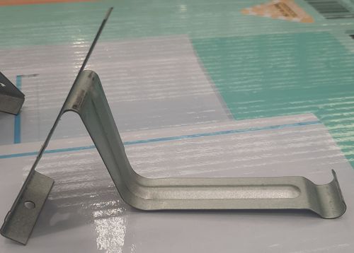

Hi Mitchell, just a question about these gutter straps. Just to confirm these are the correct ones? Also, I assume the back wraps around the outside of the fascia/gutter and, if so, the pre-drilled holes are redundant because I cannot get to them. Am I on the right track or off the rails? Thanks.

Those are internal gutter straps. Do they look the same as your current ones? The alternative is the older-styled external straps. Both of those styles are designed to be installed before the guttering is clipped into them. So, unfortunately, the fixing holes are not redundant, as you'll need to remove the guttering to install the straps. Bit of a pain, I know.
