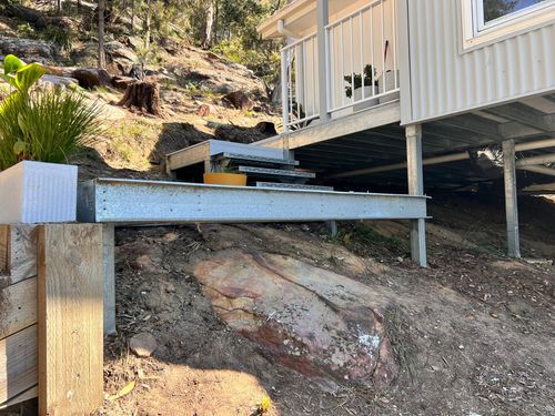

Hi all - I would like to box in the side of this deck by using 40x19 blackbutt wooden slats. How would I go about fixing them to the side of the platform - it is galvanised steel. Thanks Nikki.

The easiest way to fix your blackbutt screening battens to the steel frame is to start by mounting a couple of horizontal lengths of timber, such as H3-treated 70 x 35 mm pine, directly to the face of the galvanised steel beams using self-drilling metal screws. Once these horizontal timbers are in place, they provide a secure surface to which your vertical battens can be screwed to with timber screws.
I assume your battens will be vertical. The horizontal treated timber will give you a solid mounting point for the top of the battens. For the bottom, near the rock, it’s best to provide a mounting location there as well. This could be done by attaching another length of treated pine to the rock using brackets, fixed with Dynabolts or a threaded rod set in Chemset. This will give your battens stability at both top and bottom, creating a neat and secure screening feature.
