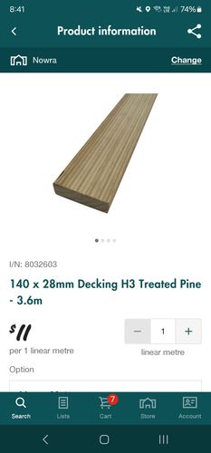

Re: Attaching a handrail to decking post
Is this timber available to order?
The Special Orders team at your local store should be able to order it in for you @wattosark
wattosark
Growing in Experience
Thanks.  I will ring and check.
