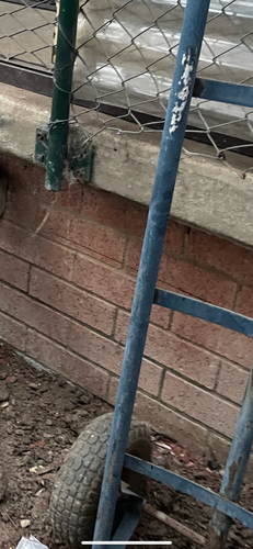

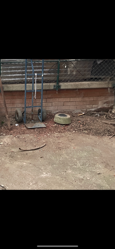

I’m in the process of building a deck (4.8x 3.0) and I would like to attach a ledger board/ waling plate to the existing concrete patio. However the issue I’ve come across is there is about a 50mm overhang from the top of the concrete meaning the ledger board will sit underneath and have no room for the joists to sit on top. Im using 140x 45 TP.
The only solution I can think of would be to laminate 2/145x45 and attach that to the concrete with dynabolts (20x160). I have thought about using posts instead and have the deck freestanding, however due to stormwater there is no option to have posts in the corner.
Does anybody have any advice or solutions to this?

I can see your dilemma with attaching the ledger to the wall with a concrete overhang. Would cutting the concrete be an option? You could hire a concrete cutter to trim that lip off and it would solve that issue. I would suggest using a steel "L" beam but this option requires the services of an engineer and is expensive. Laminating the 145 x 45 together would be a cost-effective solution and you won't have to use anything special to build your deck.
