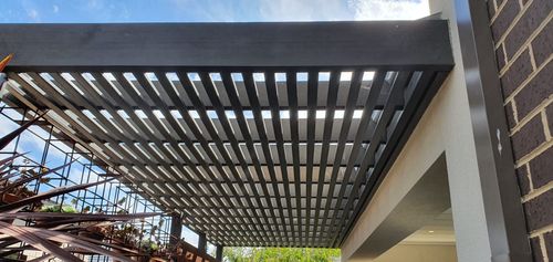

Hi team, I am trying to attach pergola joist on the existing alfresco area with 140x45mm timber. What is the best way to do it? Need some help on choosing correct bolts and how many needed to secure it strongly?
Thanks
Hi @manimpl,
Do you have a sketch or plan for this build that you could share so members can get a better idea of what you have in mind?

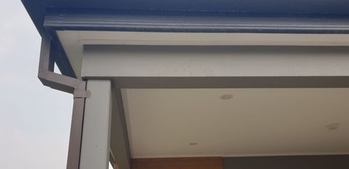

Hi Jason, I am trying to replicate the same to my house. The difference is that I am attaching it to a timber frame, as per my previous photos.
The length is 5.7m and the width is 1.9m. Please let me know of you want further details.
You'll need to have an engineer assess the house beam to ensure it is structurally capable of supporting your new structure. If it is, they can provide advice on attachment methods. Without that knowledge, you'd want to create a self-supporting pergola structure with additional posts instead of attaching to that beam.
Unfortunately, without information on whether that beam is already at max capacity, we can't know whether adding your structure will compromise it.
