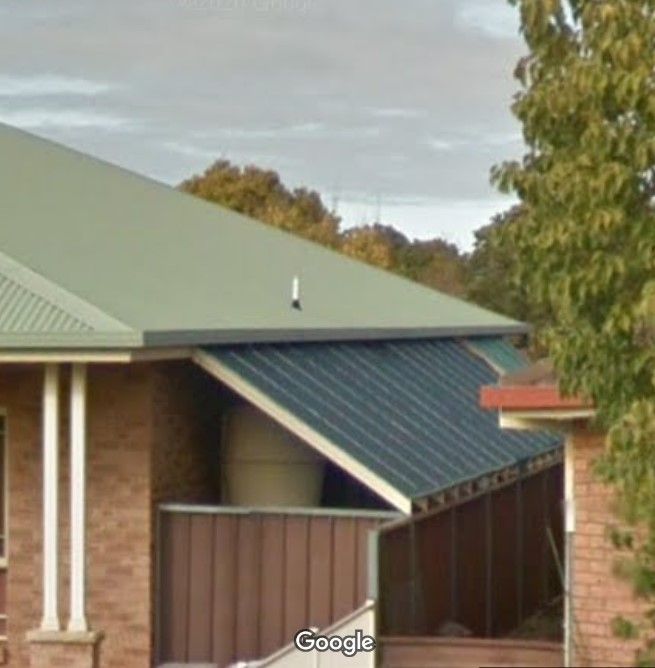

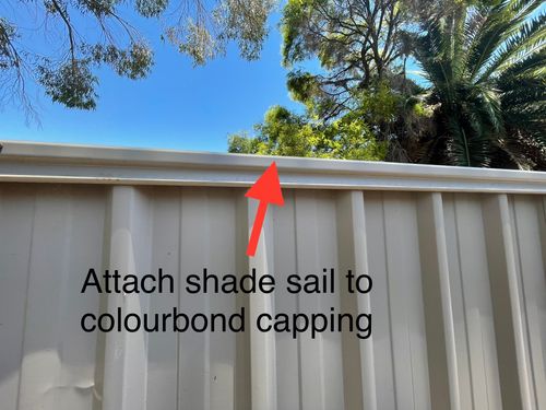

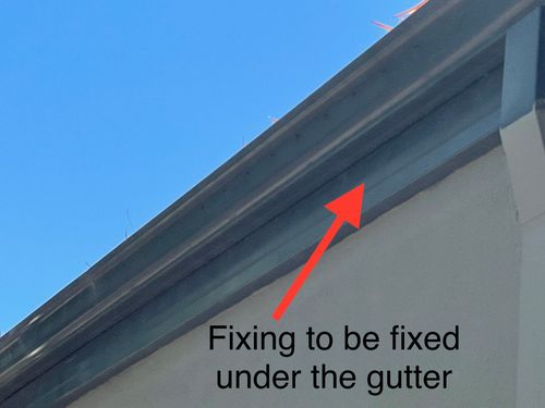

Just wanted to know what I can use to attach a shade sail from the roof side (I was planning to use a fixing of some type to fix under the gutter area shown in picture 2) to the top rail of the colourbond fence (shown in picture 3).
Picture 3Any help would be great as its my first DIY project in the home.
Picture 1
Picture 3
Picture 2
Welcome to the Bunnings Workshop community @littlediyman. It's brilliant to have you join us, and many thanks for your question about attaching a shade sail.
Strictly speaking, neither of those two locations is appropriate to have a shade sail attached to them. The Colorbond capping is not a structural member, and I'm not quite sure what that board is under the gutter. Is it timber? If so, you'd be better off attaching directly to the brick wall.
If this is just a small shade sail, then you could likely get away with attaching Coolaroo Shade Sail Pad Eyes in both locations. You should find this step-by-step guide useful: How to install a shade sail.
@MitchellMc Thanks for your response, I wanted to install the shade sail the whole length but may not be a good idea without some posts, the piece underneath the gutter is the same material as the gutter.
Cheers
Concreting in suitable posts would be the way to go, @littlediyman. If that is just steel flashing, I'd suggest using the wall as the anchor point.

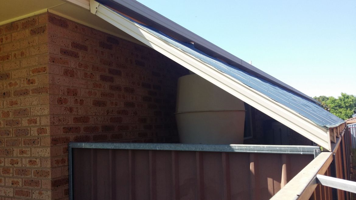

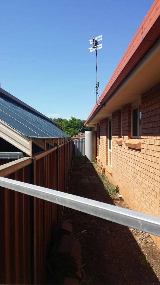

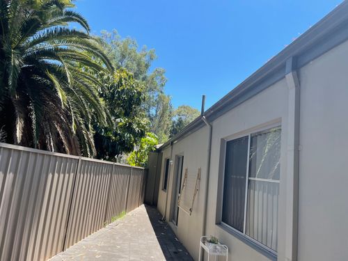

I know this post, the one I've come across while researching ways to put shade cloth from my exterior roof line of my house to the adjoining boundary fence/Colourbond as @littlediyman was trying to get information on late last year earlier this year.
I am in the same situation, but actually have a few pictures to share that may give @MitchellMc a clearer picture of what I think ?? @littlediyman may have been trying to ask of you Mitchell?? not 100% maybe @littlediyman can confirm or deny if this is what he was trying to explain and if so how did you get on @littlediyman ??
I have seen this done many ways, but the one my neighbour has, which is super strong, with the shade cloth supported and attached to aluminium braces, every 500/600mm was there when they purchased their home so he doesn't have a clue..Pitch from house to fence
Opps, My side of house veiw that I want to do the same some how?
Front adjoining Fence view
My neighbour has it on his side of the fence which makes it difficult for me to do the same as he has utilised the top of the adjoining fence. Some advice would be super appreciated as I don't even know if this type of shade cover even has a name.
Please forgive me if I have confused you all.
Thank you in advance folks for any advice you maybe able to give me.
Oldgal-24
Interesting, @Old-gal24.
You could construct the same set-up by offsetting the beams to the neighbours. Theirs appears to be a proprietary system using some type of shade panel, but it looks like a similar frame could be replicated out of timber and shadecloth. I've drawn a rendering below to illustrate better.
