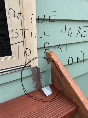

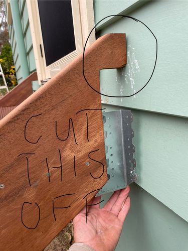

thanks for getting back to us. Uploaded some pix with new stairs from Bunnings to install on house
do we cut the notches off so it’s flush to house .do we put these clamps brackets on the stairs and house two photos with circles drawn do we screw through the top to attach to house

I believe the notches will need to be cut off in order for the stringer to be installed properly to the timber bearer. If properly anchored, I don't think it's necessary to install a joist hanger under the stringer. But before you start fixing the stairs to your house, I suggest checking your local council's rules and regulations in regards to attaching steps to your home.
