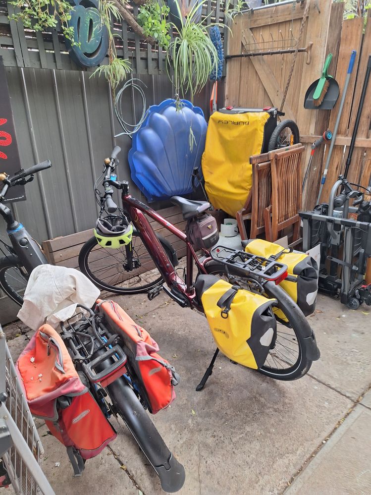

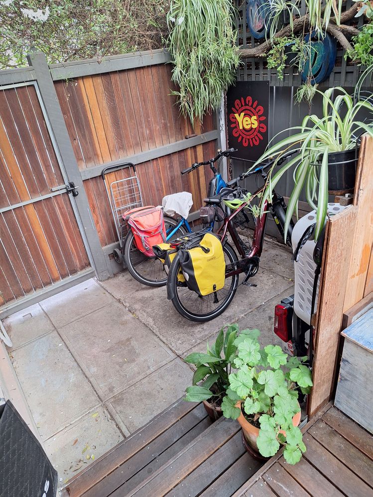

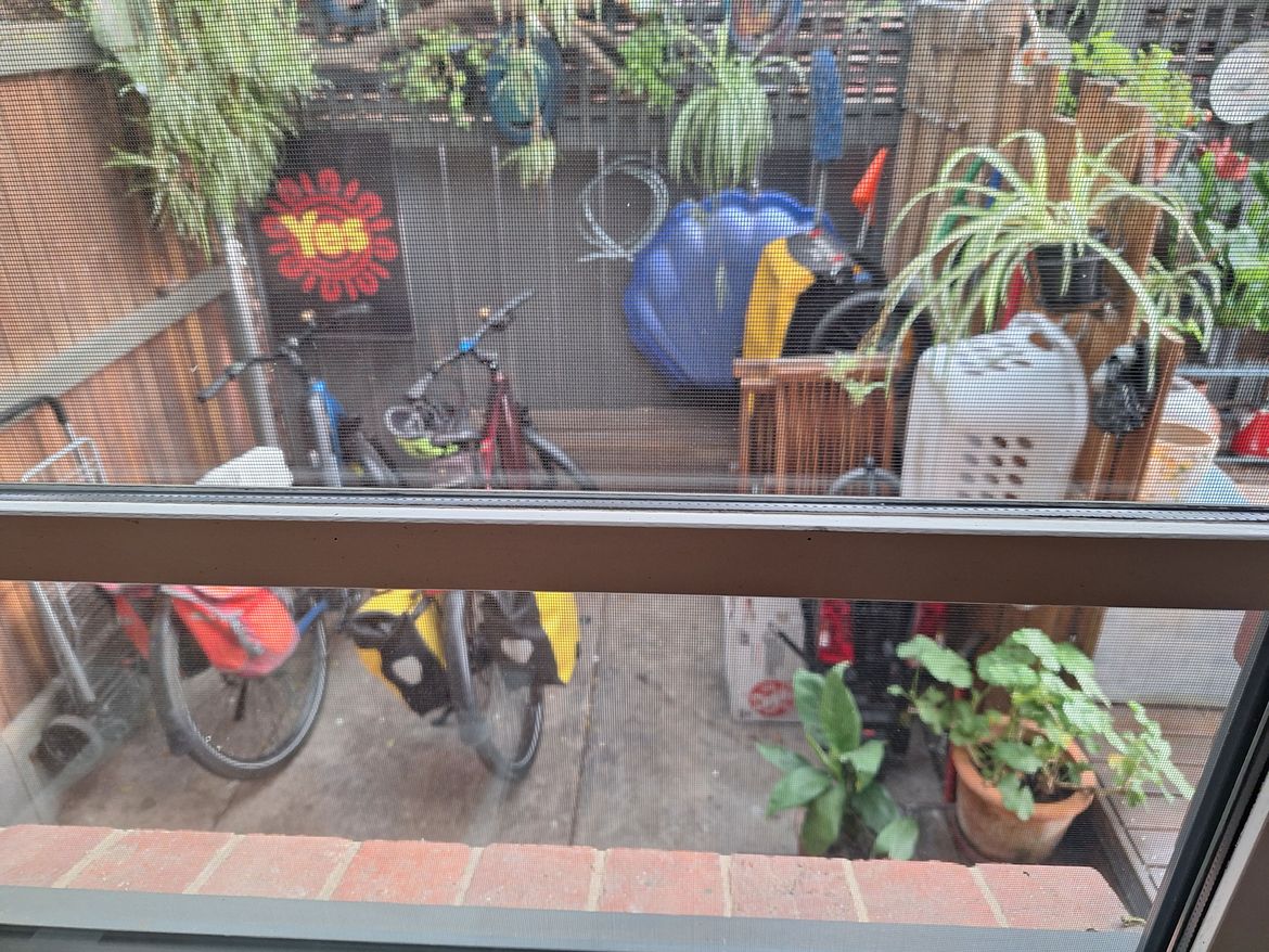

Below are photos of the area.
As you can see it not not large. I want to use tintable paints to give the impression of a rain forest floor and the impression of the forest growing up the Colorbond panels and merging with the real plants higher-up.
I'm not sure if the floor paint will work on the metal panels as well?
Any hints and tips are most welcome.
Area from front gate
Main foot traffic route
Area from House
Area from Garden
Hi @MJM,
Unfortunately, specialised concrete paints cannot be tinted into the myriad of different colours that standard paints can. They are mixed from a selected base, whereas standard paint has several bases, allowing bright colours, greens, etc. Concrete paints are also not suitable for your fence. There are a few shades of green in the Ultra Pave range, though.
Dulux Weathershield is an exterior paint suitable for concrete and your fencing and can be mixed into thousands of colours. However, it's a soft water-based paint and is nowhere near as resistant to wear as a dedicated concrete paint.
It would likely be best to use the concrete paints for the concrete and then Weathershield for the fence.
Preparation for the concrete paint would involve using the specified concrete etching product and cleaning the surface. For the Colorbond, scrub it down with a Scotchbrite pad and Sugar Soap, then flush it with fresh water.
