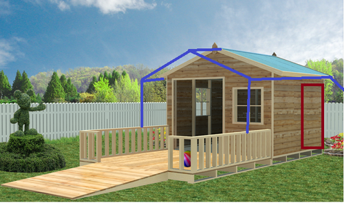

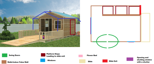

DIY WHEELCHAIR ACCESSIBLE CUBBY HOUSE
I'm wanting to know the dimensions and the type of wood I would need to build this for my son, would also like platform stair inside the back of the cubby house that exit at the red rectangle to a slide that is also undercover
The blue lines indicate an extended roof that is only roof, so he can park his wheelchair if needed.

This looks like a great project @Cstar.
Some things to consider;
  • Do you need it to be raised which requires the ramp, or could the floor inside be your natural ground? This would make your design a) more simple (not requiring a ramp and the additional cost/effort of subframe for flooring), and b) would take up less space in your yard.
  • What level of ability does your son have? Does he need to get his wheelchair inside the cubby or can he transition to chairs/benches, etc?

@ProjectPete My backyard is grass and my son has sensory issues, so will definitely need to be raised.
He is able to move around (crawling) but is unable to walk so there needs to be a lot of room on the inside for him to move freely.

- To help reduce the height required for adequate airflow below the floor I suggest using Formply as it's sealed and protected from moisture. I'd then buy lengths of 200x50 H4 sleepers and rip them to lengths of 65x50 to use as your subframe - I say H4 because they'll be in constant contact with the grass/moisture. H3 would warp/now over time.
- Use a decking solution for your ramp and verandah area. H4 sleepers ripped to triangular shaped would be best for your frame again given constant contact with grass/moisture.
- Your wall and roof framing would be fine with 90x45 H3.
- Use desired size H3 for making the fence, etc and ensure they're painted.
- Fibre cement (FC) sheets/cladding is the best option for the exterior finishing however Bunnings also has suitable shiplap pine cladding which you can use. 3 coats of quality exterior paint will keep it looking good for quite some time.
Hope this is a good start for you.
Happy to help with your actual plan/layout when you get to that point.

Well why don't you start by sending me the basic/outer dimensions - length, width, height.
That way we can work on the frame structure, etc and the materials required.
Include things you'd like such as side of doorway, windows, shelves, etc
