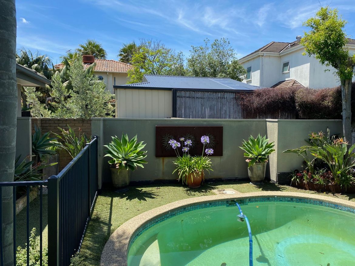

This backyard's pool area has a 1.8m tall partition wall separating the pool area from the pump and pool equipment in the back corner and clothesline at the left side.
We are looking to remove most of this partition wall to open up the space to the fence line. There will be a new section of "partition" joining the left edge of the existing partition wall to the fence line so that the pool barrier remains intact as per regulations.

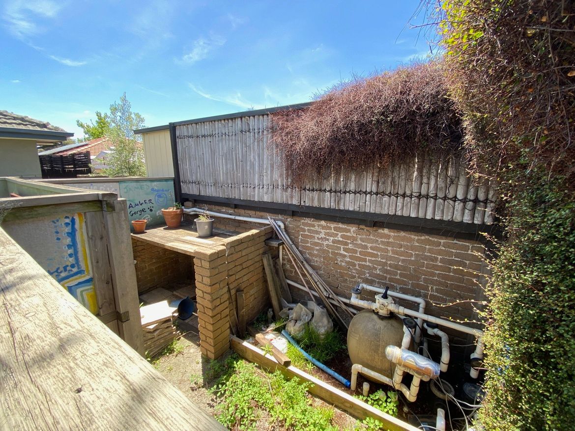

We'll remove the brick bench / storage area and want to replace the bamboo section with a 3m tall cement sheet wall that will run from the back corner of the block along the fence line to about in line with the back of the house. The brick fence will stay. Pool pump will be enclosed in a bench seat type unit and the entire area will have fake grass extended to cover. The new wall will be about nine metres long.

- what if, when digging the holes I strike the concrete footings of the brick wall? Do I just bring the posts forward and sacrifice a bit of the garden depth?
- I'm assuming I shouldn't use many (if any?) attachments from the new wall into the brick fence especially as some of the existing supports (the brick storage thing) will be removed.

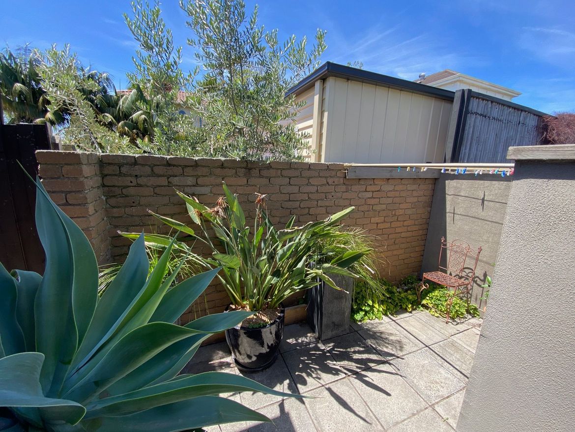

The wall that is currently behind the hard to see clothesline (pic with the paving) will be moved forward so will act as a brace as well.

The rule of thumb with posts is that one third the height out of the ground should be in the ground, so in your case to create a 3m tall feature wall, your posts will need to extend 1m into the earth. Posts with a total length of 4m are not always stocked in our stores, so I'd suggest speaking to the team at your local Bunning's Trade Desk about what is available from local suppliers. It is likely there will be posts that can be special ordered. Make sure they are H4 treated for in ground use.
Posts in concrete are your best option for this. I'd suggest coating the in-ground portion of the post in Gripset Betta 1L Waterproofing Membrane Bitumen Rubber for an additional layer of protection.
If you strike the concrete footing for the brick wall, you may be able to chip away some of it to create space for the post, but this risks weakening the brick wall's footing. It's probably best to just move the posts forward a little bit to avoid this.
You should try as much as possible to keep the structures separate. They can be tied together, but it should not be in a way where one supports the other.

Striking the concrete of the support for the wall, if you do hit the foundation, how far out does it extend from the wall? if its only one spot or two maybe you could use stirrup styled support and bolt that to the foundation? Remember you shouldnt drill within 80mm ish of the edge of the foundation as you dont want to chance cracking it.

Highly recommend following the advice of both @JacobZ and @Dave-1 as they have already covered anything I could add to the conversation. The only thin g I could add is not be too concerned about even savings between the posts should you strike concrete footings in the holes you're digging. Trust me that the effort to break these up to remove them will be exhausting. Positioning the posts offset to these will not be ideal in being evenly spaced, but you will be the only one to know.
