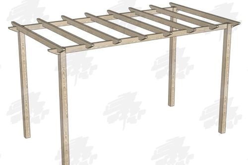

Hi, I'm planning to DIY a 3x4 garden pergola, and i just want to know the timber specs that i should use for the post and frame? My initial plan is to install a 4 post using 100x100mm H4 treated timber and having a square frame around using either 200x50mm H3 treated or 140x45mm H4 treated timber.

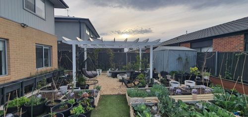

Update. After a long planning i already finished my DYI project by my self, from posts digging up to painting. All materials and tools are all from bunnings. Thank you everyone for sharing ideas. Thank you and more power...
That looks like an extremely solid pergola with some beautiful accents. It looks like a great place to sit and enjoy time with your friends and family.
You have done a brilliant job turning your vision into a reality and I am so glad to know I could help, even in a small way.
