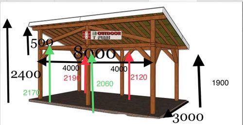

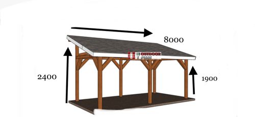

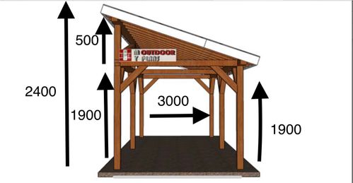

Hello,I'm wanting to build a shade house structure similar to the below with pine posts and shade cloth across the topNeeding some help with a material list please. Will likely be 8m long & 2m deep

I was wondering at the fall of your roofline. The low point would be pretty close to knocking someone on the head. Could you have a shallower fall to allow taller access at the front? Looking at your pics, you have the crossbeams at 1.9m also. Are you set on the 4m span bewteen posts as that is a fair distance? I would probarly think 3m maybe but I am a conservative builder. @EricL will have a lot more knowledge. I will be back a little later after having a think about it 🙂

Thank you for sharing your question about building a bonsai shade house. Because of the size of your proposed footprint, I suggest checking the rules and regulations of your local council regarding building this shade house. It would technically fall under building a pergola only without a fixed roof as you'll be using shade cloth as your cover.
Generally, the post most often used are the 100 x 100mm Fence Post Hardwood CCA 3.0m in combination with 90 x 45mm Outdoor Framing MGP10 H3 Treated Pine - 3.0m for framing. But it all depends on the type of structure being built, I recommend engaging the services of a drafts person to draw up a basic plan for your shade house.
You can then specify your needs and how large you want it to be. It will also answer all your building questions regarding timber size and what fixings to use to keep the structure together. The drafts person will then draw the plan to code and should the council rules require a plan you'll have a formal plan you can submit.
