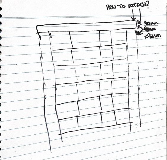

Before I send photo updates, wanted to run by you how to properly mount the top of my frame to the timber post on the sides of my wall?
Currently, my side posts are 90mm x 90mm and I plan to put the same timber post on the top of the frame to cap things off. I will get it cut in store and this is the brand I purchased for the side posts.
I need your help with - what screws to use, and what drill piece I'll need to actually get through these pieces - none of my drill pieces have the length to get through the first 90mm??
Wall is looking great, just at this final hurdle. Have attached an embarrassingly bad sketch to explain what I mean.

I trust @Jewelleryrescue will get back to you shortly, but in the interim, I'd recommend using a Sutton Tools 6.0mm Long Series Jobber Drill Bit to pre-drill your top horizontal post and then also to pre-drill your upright posts for the first 50mm. The posts can be fixed together with at least two, preferably three, Buildex 18 - 7 x 200mm Landscaping Construction Screws on each joint.

Excellent   progress I was  wondering how you  where getting on.
Your  drawing is   absoulutly fine @bodega  it conveys your information your need to get your question answered and tradies  and DIYers have  being doing mud map sketches forever on building materials scrapes of paper and box lids.  I bet if you turned a  stone over on the  pyramids you will  find a drawing explaining how they built it  lol as they had to show the workers  how to do it.
Ok  Your timber is a  picture frame encapsulating the brick work and they support each other and the brick work ends  protected.
All you  need to  do is  join the timber top bit to the lower uprights.
I would  use long coach bolts for that 2 per post should be more than  enough  Drilling in at the side of the top rail into the timber post below.
It is not hard to do  but let me out line the steps and  materials and tools.
Coach  bolts
4 x Zenith M10 x 150mm Hot Dipped Galvanised Hex Head Coach Screw
I/N: 2449420    $1.94
4 x Zenith M10 Hot Dipped Galvanised Washer  I/N: 2442070  0.28
USE  M10 washers  1 per  bolt   it helps weather proof  the  timber  from water incursion.
Extra long drill bit
Sutton Tools 5.0mm Long Series Jobber Drill Bit I/N: 6353673  $13.75
Thoughts
The idea is to pre drill holes through the top of the cross beam that align with the meaty wood cross section of the 2 upright posts.  (We dont want screws near the  post sides. as they are weaker there  and may poke out.). So  We  pre drill the holes for the bolts to easy screw  through  and then all you have to  do is Optionally pre  paint post ends.  Next sit cross beam into place on top of posts aligning  pre drilled  holes and screw coach bolt down with a  shifter spanner or a socket set or other tool (dont forget washers.)
The  bolts are on the top so they are not  easy seen.
Coach  bolts displace alot of timber when we screw them in  and will cause the timber to expand and  split. So its  best to pre drill a hole as deep as you can for the coach bolt.  I would also partly drill the second timber starting point as well so only the coach bolt  threads into the timber with out splitting it.
Drill diameter is roughly 50% bolt dia where the screw thread is If  alll you have is  short regular drill bits  go as  deep as you can,  Some times I try my luck and drill from the bottom to meet the top  hole .  It nevers works but  this dose create space  for entering bolt to displace timber a bit .
Hope  this   helps you .
