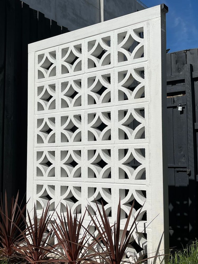

Apologies on the extremely late delay but just wanted to send images of my completed Breeze Block wall that you helped me with.
It turned out great and no doubt wouldn't have been possible without your assistance and very detailed instructions.
The wall is the main feature of my on-going, several year back yard project I've been working on for a few years now. The wall was completed around March 2024 and I've since landscaped the entire backyard around it, which is slowly taking shape.
Thanks again, your guidance and patience with me on this was second to none!

Hello @bodega
Thank you very much for the photo update. The breeze block wall looks fantastic! I'm sure @MitchellMc and @Jewelleryrescue will be happy to know that your project is now finished.
