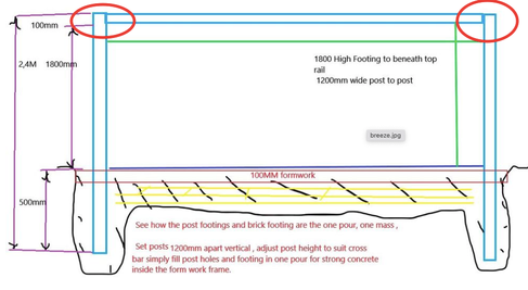

But if your  up for it no  harm in adding steel reo if you want to if you can you should do it see what you think about the diagram below Exposed block work pier.
Brick work can tower stories above the ground and they need high levels of reenforcing  including the grooves made into breeze blocks this is how  reenfrcing will look as its supposed to be  pinned into the concrete footing and the side walls and footings.  So If  you want to feel free to add 10mm Reo rod horizontaly and or vertically on  every  layer you can see now how its done. But  do try use one piece per horizontal (Maybe 2 over lapping rods for ease to push into side timber posts) and vertical across all bricks  for maximum strength as per the  diagram  Drill into timber posts sides if you wish too for super support.  Also  notice the steel plate on the top. Some completly box in the bricks in steel we are adding a timber  frame instead. :smile:
The above drawing shows reo every 4 bricks you can do any reo  combo  you like here for your wall horizontal vertical for  every brick row and column If you want vertical reo drill cement holes after cement set at brick mortar measurements.

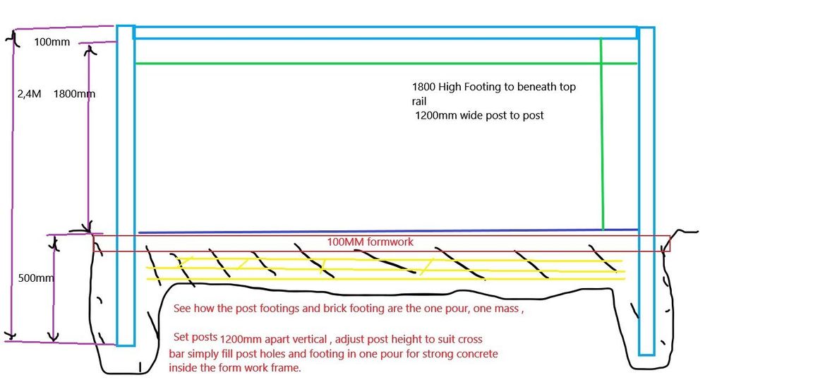

See attached  rough sketch (not to scale) see how the post footings are one and the same as the brick footings the black line is bottom of cement shape.
Take your time in preparing  now it will be worth it.
Dig your post holes 600mm .dig the connecting footings 300mm
Put plastic in trench if you wish optional not in post hole.
Build rectangle form work around both posts and 300mm wide  lift and position frame and  screw it to pre hammered in stakes on outside of frame.
Reminder the formwork top will be your brick laying surface level. Top of your concrete to make filling and smoothing  easy.
Add  your reo steel too footings and put rocks under it so its in concrete middle.
Calculation
I am assuming a 2.4Metre post x 100 x100mm  notice I put the cross bar inside posts that means 1800mm brick  gap plus 100mm for top rail that leaves 500mm below ground
Stand your posts in the ground and lift them and put a half brick under them? so they are 1900mm above the formwork top Ie 1800mm for breeze bricks space and 100mm for top bar.   so that leaves  (2.4m - 1900 =  500mm below  ground. )
Prop your posts level.
No relaese agent required timber wont stick to cement.
Pour your  quite wet /runny cement.   Giggle and prod cement down thesides smooth top.
Sign  your cement. Have a  sit down you earnt it.
Wait 1 week for cement to cure to good strength to take frame off ,else the sides might be damaged.

You mentioned in last post, and in drawing (circled with red):
"Notice I put the cross bar inside posts".
Question - does the cross bar need to be inside the posts or can it sit on top of the posts to encapsulate the bricks?
I'd prefer to have cross bar on top of the posts instead of inside as it adds just a bit more height. However, if this effects stability I'm happy to pass.

Hi @bodega
You can  absolutly put it on top if you want too there is no problem there at all.  You can put in 150 mm coach bolts going down into the posts and the heads will be hidden on the top,  Just  remember to a just  your post heights down  or trim them off later.  Double  check  your wall will fit inside the dimentions you are creating.
