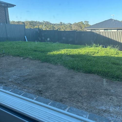

Hello, building a deck at my backyard, need some help on sub structure. Size of post, joist, bearear and also layout. Deck size I am looking to build is 12.5m wide and 4 m length. Please find the Image of the area. Thank you.

Unfortunately, due to the size of the deck you're looking to build, you will require council approval for this deck to get built.
I'd suggest you start by contacting your local council so they can assist you with understanding your requirements in terms of planning.
It's likely that you will have to submit detailed building plans that are prepared by an engineer or draftsman. They will be able to assist you in designing the deck.
Frequently 100 x 100mm Hardwood Posts and 140x35 H3 Framing Pine are used as the posts and frame for a deck, but the choice of materials come down to the specific layout of the deck, so the draftsman or engineer who assist with the design will be the best person to tell you what specific materials you'll require.
It is also worth having a look at these Timber Span Tables from Hyne Timber which will give you an idea of common decking materials and the distance between support, either from a post or a bearer, that they can span.

I've gone ahead and mocked up a sub-structure for you. It uses 90 x 45mm timber, the joists are spaced at 450mm centres, and they are supported every 1000mm.
