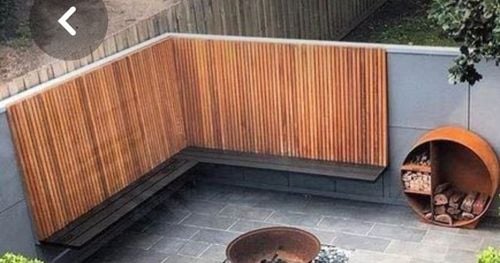

I am planning to build something like the photo attached below adjacent to my colourbond fence in the backyard.
I dont want to attach the screen directly to the colourbond fence.
What are my options here? One option I can think of is to Add a few posts into the ground then run a timber across between the posts then put the batten wood on the front of it.

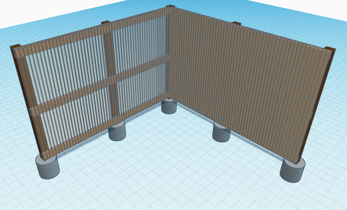

Your first option sounds like a solid plan to me and would be my recommendation. I've constructed a rendering for you below, which should help illustrate my suggested method. You'd concrete in some H4-treated Pine posts and screw H3-treated 90 x 45mm timber to them. You'll then be able to screw your batons to the horizontal timbers. Consider screening panels instead of individual batons, as they could be more economical and would be easier to install.
