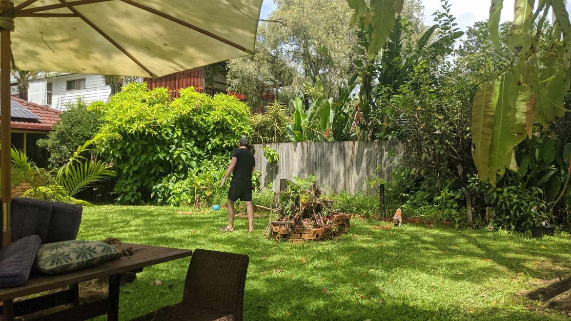

I don't know the diff between a cabana and a pergola, but it feels like the right word. I'd like to build a 3m x 8m outdoor semi-enclosed covered area out the back. I know the requirements as far as council goes, but what i'd love some help with is getting the cost to a bare minimum. Any ideas would be welcome.
Here are the specs: 40cm above ground level. 2.5m high at back (2.1m inside), 3m high at front 2.6m inside) It will be going alot the fence, 90cm ffom fence with 2.5m high side at back, increasing roofline to 3m high at front..
