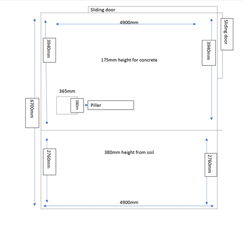

I am looking to build a deck as per the attached picture. Could you please advise me of the materiels needed and the spacing .
Planning to go with composite decking board and tuff block. Please advise.

You'll have to consider the direction you want your decking boards to run as this will determine the layout of the frame beneath. I am happy to help with a design for your framing when you can let me know which way you'd like the decking boards to run.
Unfortunately, TuffBlocks won't work on the concrete area because of the height restriction. You will need to use a lower profile pedestal such as these Builders Edge 25-40mm Minifoot Pedestal Feet. By using these low-profile pedestal feet, you can use 140x45 H3 Framing Pine for your deck frame which allows your bearers to span 1400mm between pedestals and your joists to span 2600mm between joists.
For the stepped-down area, you can use the Tuffblocks with 90x90 posts to raise the height of the deck, so it is the same as the concreted area.
Here is a possible layout for your frame that would have the decking boards run parallel to the sliding door at the top of your diagram.

Thanks for the advice. I was planning to lay the decking board parallel to the sliding at the top of the diagram.
I will be very happy if you could help me with the design of subframe.
The finish hieght from concrete is 175mm
So the Minifoot 25+ 140 frame+ 23 deck board=188
Could you please help?

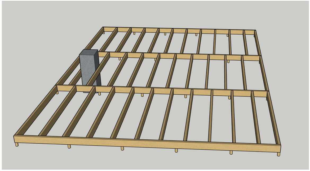

Screenshot 2025-02-05 at 1.15.52 pm.pngScreenshot 2025-02-02 at 11.22.59 pm.pngHi Mitchell,
please advice if I am travelling in correct direction.
Planning to go with diagram proposed by Jacob
H3 pine 90x45
Planning for 5 bearers with joist span of 1400mm (total length is 6700mm)
bearer span at 900mm with small foot pedestal feet
For the stepped-down area, I will use the Tuffblocks with 90x90 post
Kind regards
Joice

Hi @Joicekocheri,
Since you are going down in bearer size from 140 to 90mm, you'll need more of them. I've created a rendering below.
Joist span can't be further than 1000mm with 90 x 45mm. Supporting the bearers at 1000mm should be sufficient.
