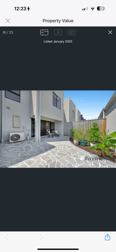

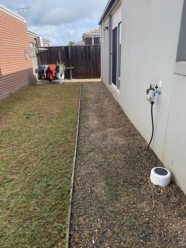

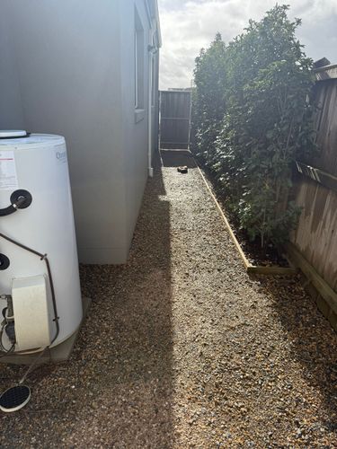

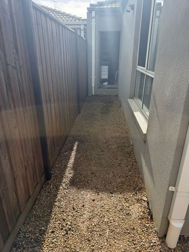

I’m planning to do the Crazy paving at the back and sides of my house. I kind of know the process because i have seen people doing it and have also gone through many videos. I would really like to get help from the workshop community to guide me through this.
Firstly i was planning to do get the concrete done over here but now i have changed the plan and do the crazy paving by myself as it looks bit more aesthetic to me.
I have uploaded the pics of the area and also another picture which inspired me for it. If anyone knows, could you please tell me what kind of pavers and fillers have they used.
The length of the house at back is 14 meters, sides are 13m and 6m. I would also like to calculate the cost for the same, would you be able to help me in that too.

To begin, take some time to sketch out the exact areas you want to cover. You’ve mentioned the lengths at the back (14 m) and along the sides (13 m and 6 m), so figure out how far out from the walls you’d like the paving to extend. Even a one-metre width gives you roughly 33 m² of coverage. Having this sketch on hand will help when you start planning out your materials.
Next, let’s talk materials. Your inspiration image looks like bluestone, similar to these Tuscan Path 800 x 400 x 20mm Bluestone Pavers. As these pavers are a fairly large size, you can break them up and customise them a fair bit. You can break them up with a rubber mallet to create those crazy shapes that are so desirable.
