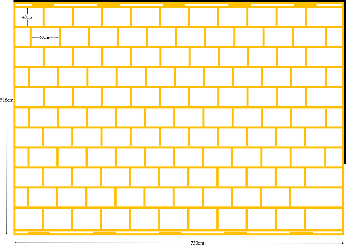

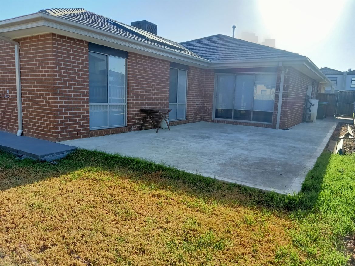

I'm planning to install a deck in my backyard and have drawn up a plan. The dimensions of the deck are 518 cm by 732 cm, and I plan to put the joists on the concrete elevated from ground with a Macsim Fasteners. The joists will be spaced 40 cm apart as depicted in the plan below.
I've attached a diagram of the plan for reference. Can anyone provide feedback or suggestions on the design? Specifically, I'm looking for advice on:
  1. Whether the joist spacing are appropriate.
  2. The recommended size for the joists to ensure proper support and safety.
  3. Any tips or considerations I might have overlooked.
Thanks in advance for your help!

Re: How to build a deck over concrete?
Hi again @rbouadjenek,
Your plan looks rather solid. My only suggestion is that you could push the joists out to 450mm centres (as that's adequate) and remove half of those noggins, as they are not necessary. Just remove every other one from your design.
90 x 45mm is what most of our member use for their joists.

Thanks a lot for your feedback @MitchellMc
I have updated my plan based on your suggestions. Could you please double-check it?
I have one question: Can I use 70 x 45mm joists instead of the 90 x 45mm size you suggested? The 90mm joists seem too thick, as the gap between the concrete slab and the door entry is only 11cm.
Hello @rbouadjenek
Using 70x45 should still work with your proposed plan. Although I concur with Mitchell regarding using 90x45 as it will make your frame robust. But since you are using a great deal of noggins your decking frame should still come out rigid.
My best advice is to place a 6mm gap between your deck panels to provide maximum allowance for moisture to escape under your deck. I also propose checking the water flow on your concrete base. Make sure that water flows away to your garden and does not pool in the middle of your concrete base.

Thanks a lot for your advice @EricL ! There should be no water issues, as the entire area will be covered by a waterproof pergola.
Then I will go with 70x45 joints :smile:
