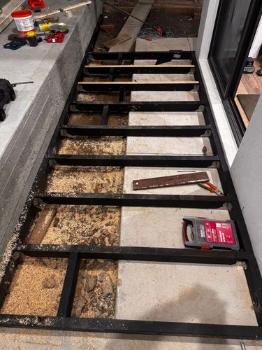

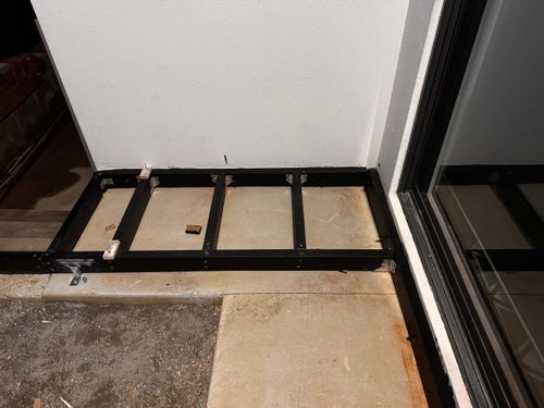

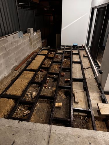

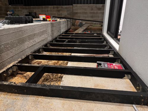

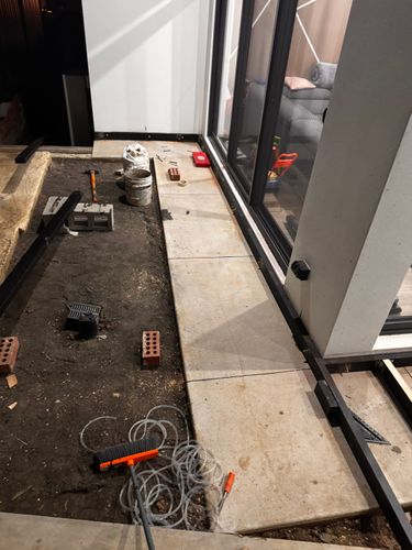

I have started the deck and almost finished the framing structure attached the photos please have a look
Its a L shaped deck

Hello @savtar13
The choice is up to you regarding deck panel sizes, I personally prefer using the 90mm sized panels as the different shades of the decking timber are more visible when laid out.
I suggest using 10g x 65mm decking screws. This is the common size used for decking panels. When you think of how it is embedded in the timber 20mm will be buried into the decking panel and the remaining 45mm will be drilled into the decking frame. So, 2/3 of the function of the screw is to hold the decking panel in place. If you happen to be in an area where strong storms pass regularly, then it would be worth putting in larger screws. Just remember to drill pilot holes for the screws to prevent splitting the decking panel.
Using stainless steel screws is always a plus. They provide excellent durability thanks to high vibration resistance that makes it difficult to unscrew them. It's low maintenance due to stainless steels resistance to corrosion
