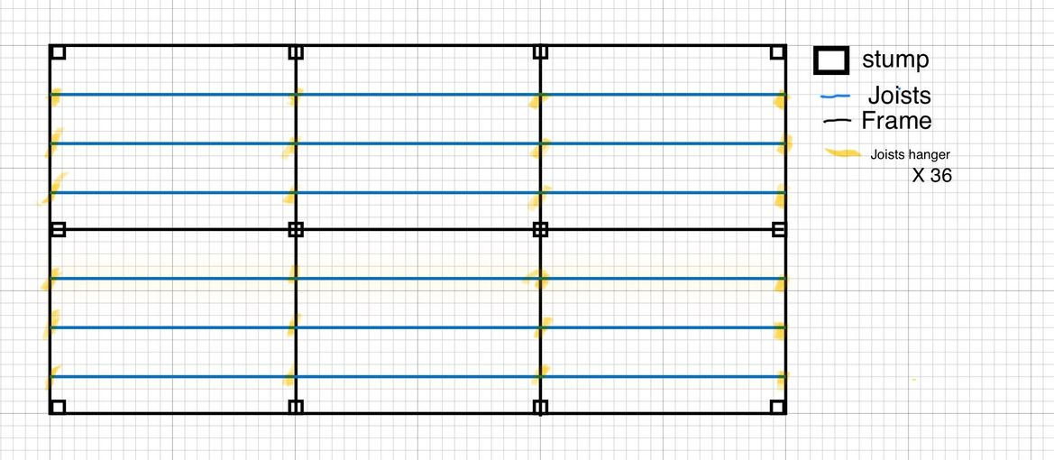

This is what I have planned so far, the size of the deck is 3m x 6m, the ground at the moment is sand, and it will be a relatively low decking and i have been thinking of 2 different options below:
1: Building with stirrup post and 90x90mm timber for stump, size for joists is 45mm x 140mm (picture below), wondering if this will be enough support for the deck?
2. Building the foundation with tuff blocks, my concerns is since the ground is sandy, will the tuff blocks sits well on the sand? or other wise if i get some concrete slab and use that as a footing for the tuff block, will the below be enough support or would i require more blocks?
Thank you
