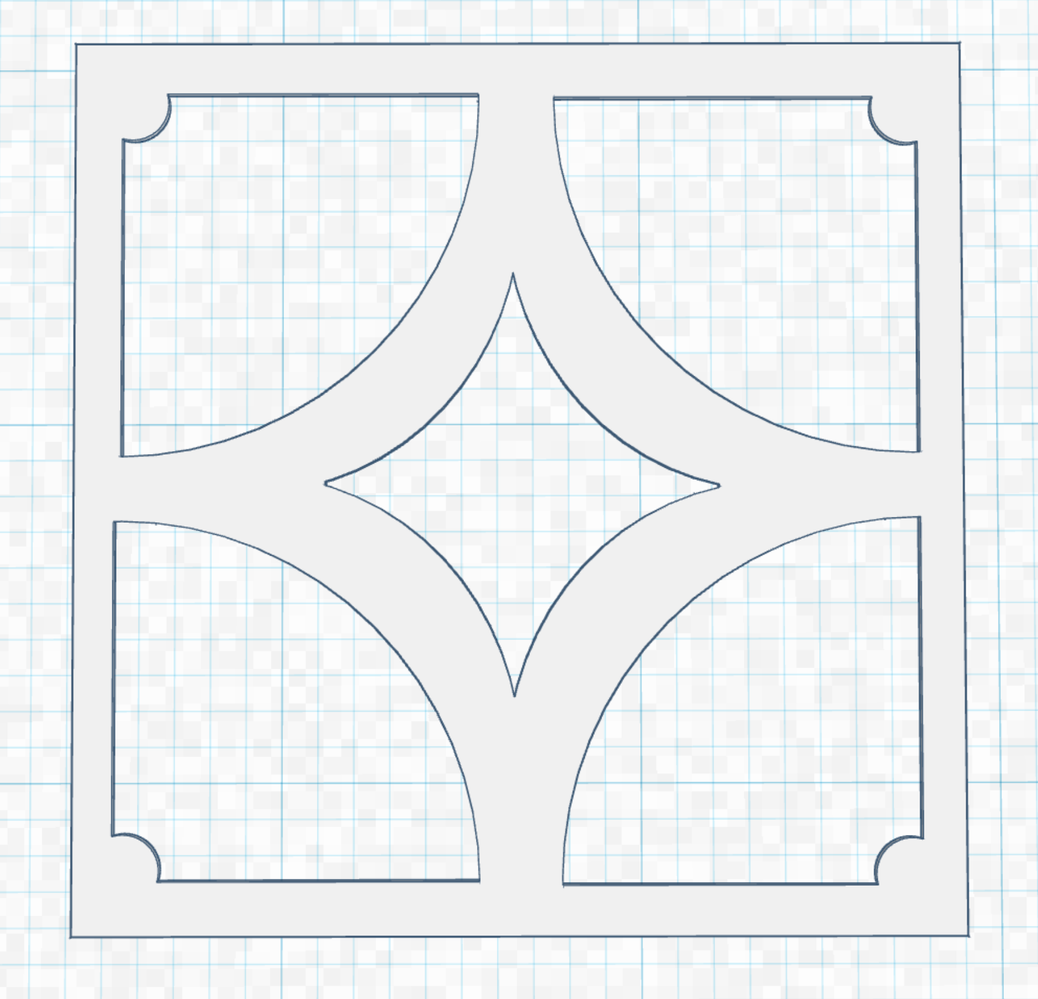

Interesting project! I love Breezeblock walls, and I'm considering giving your idea a go, too. I've taken some time and created some renderings for you. If you were to make the "blocks" 250 x 250mm, you'd get six evenly across and eight down, with some space to spare. I've isolated a single block in hopes you might be able to scale it on a printer and create your template from it. I've just eyeballed the design, so you might want to change it yourself.
Hope this helps!

Hi MitchellMc,
Wow! Thanks so much for taking to the time to mock up that rendering!
You must be psychic because I’m copying star breeze blocks I already have. I love the optical illusion the star/circle creates.
I was going to make my screen “blocks” the same size as mine 29 x 29 cm plus 1cm for the mortar lines.
