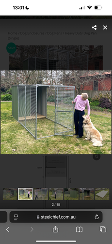

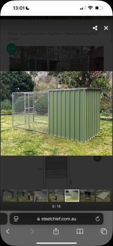

Just so our members have a clearer idea of what you’re hoping to achieve, is it something like what you’ve shown in the pictures? For example, a weather-protected area like a kennel or small shed, combined with a larger, secure run that’s fenced off and has a gate? If that’s the case, one of the first things we’ll need to consider is how secure you want it to be. If you’re thinking of using heavy-duty mesh and colourbond steel panels like in your example, the cost of materials can get quite close to buying a pre-made kit, so it may be worth browsing through the available animal enclosures to see if something might suit your needs.

Crikey... Tin box with some fencing and a gate.

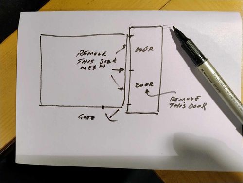

I am usually neat at sketching but currently have injured right thumb with two bandaids.
With assistance both should be fairly straightforward to erect
Do the enclosure first, the diagram says to remove the wire mesh but looking at that now maybe just cut the mesh bottom right (near the door) and swing the whole thing around to tha back and secure with good quality cable ties so similar.
If needed later on that can be restored to original.
With doggy eyeballs in mind keep checking all the time for sharp/pointy things. Bend over, cut off or cover.
Erect the shed and remove the bottom/right door.
Move the shed against the enclosure and centre the thing.
