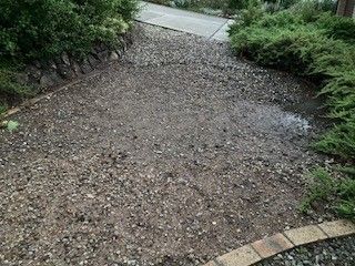

Thanks Dave  The path is going in between what was used as a parking area with a garden either side.
Looking up to the drivewayLooking up to the driveway

Hi  @Student
You can simply dig the ground a bit and sit the pavers on it for the simpelist soloution
Or
you dig out the paver line you wanted 100mm deep and use sand and cement mix and place it in 100mm trench and lay your pavers  in the wet cement use  straight piece of timber and a small hammer and tap the timber on top of the pavers so they are flat and level now lay more  pavers putting in sand and cement between the pavers.
Best method. as In your photo follow that example.
And  or use steel reo bar in under the in the cement under pavers to support the pavers even if the ground sinks in places
Wash cemented pavers with  wet dust pan  brush to get most  of any excess mortor off paver face after you lay then on the sameday will save a lot of  hard clean up.

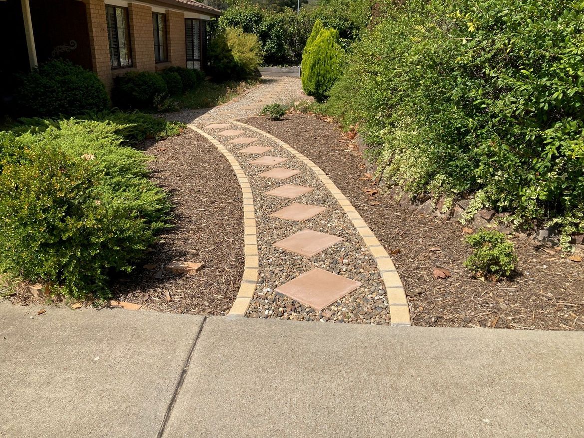

Going through emails after getting back to work (Oh fun) and realised I never followed up after you posted your pic. Did you build a path or is it in the "yet to be done pile"?
Student
Growing in Experience
Re: Using pavers as edging
Yes it has completed.Path CompletedPath Completed
Well done @Student, it looks terrific. You might need to change your username to master!
Dave-1
Community Megastar
:smile: @Student
That looks brilliant, nice effort! And no mowing :smile: Certainly will keep yopur feet dry when its raining.
How did you end up constructing it? It really blends in well.
