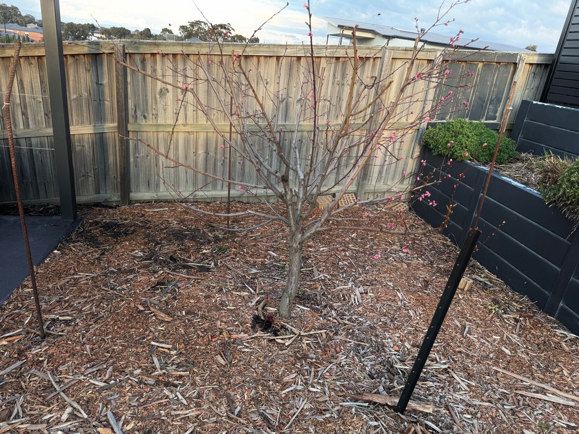

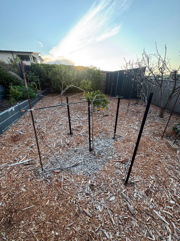

Small update
We had a friend over installing some lights so we asked him to pound in our star stakes. No concrete.
Architecturally, these are very visible and it looks very busy.
I’m not loving the look.
The round rebar is not as visible but still it’s ruining the backyard landscape.
John

Mmmm you have removed my favorite materiasl to use :smile: However I have an outside the box idea. Not sure if its possible or even wise but viewing wise it may be the easiest.
So two of the posts that @MitchellMc has mentioned (or three all up) across the width of your yard/area you want the espaliaed trees to be in. These are concreted in plus a 45 deg angled piece. Think of an old school long clothes line but instead of a horizontal drying mast, the strings/wires will be into the post itself.
You could use stainless steel wire stretched between the posts and the 45deg supports will help keep them vertical over the years as the trees use the wires to helkp carry the load.
