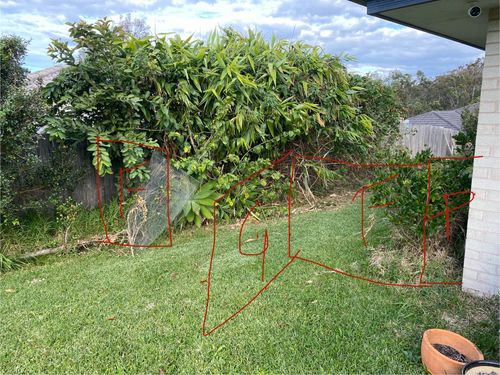

I want to build a security gate on the side access of the house to the fence. It’s about 9m wide. I’m thinking of building fence on both sides and hang a gate in the middle so not to have a long spanning gate. I want to ask if I can bolt the post to brick wall of the house.

Is it possible to grab some photos of the side access so our members get a better picture of what you're working with?

i have attached a photo with scribble on.
P= post
G= gate
F=fence.
I was wondering if I would break any rule if I bolt P to the brickwall or I have to build an adjacent brick structure and bolt P to that.

Hi @randomdiy,
No, no rules state that you can't do this.
Everything looks in order for you to get stuck in.
