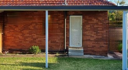

I was wondering if you can kindly help me with the following as I'm planning to build a low level deck due to land sloping down towards my backdoor.
1. My pergola is 25sqm, would I need to connect the downpipe to a storm water drainage? the downpipe is on the last pole on the right hand corner. The storm water connection is very far down the house on the side.
2. What is the minimum clearance would I need for a low level deck if i'm planning to use Galvanised post, H4 for bearers and H3 for joist?
3. As my land slopes down towards my back door and water seems to flow towards the house, is there a drainage issue I need to think about? If so, can you please kindly recommend me a solution?
4. I plan on digging up the grass, which weed mat would you recommend to purchase? Would you also recommend the clips or drainage sand?
Any additional advice to what I have not thought of would be much appreciated ![]()
Many thanks for your help!!
Hi @penpan8988,
Have you considered a slightly raised deck that you'll walk directly out the door and onto instead of down the stairs? You can add steps down from it and into the garden off the deck. The reason for asking is you'd typically create a low-level deck when the door threshold is low to the ground, unlike yours. Secondarily if you have a sloping yard, you'll need to deal with the water runoff and the downpipe, as you can't have that water sitting under a low-level deck. By having an elevated deck, you could possibly avoid installing additional drainage and ease of access would be improved since you don't have to walk down steps onto the deck.
To answer your questions, you'd need to connect the downpipe and Slotted Draincoil you've run across the rear of the house to collect runoff to the stormwater. I can't give you an exact minimum clearance for your deck, as the higher you can make it, the better. Limited airflow through the deck's structure is the leading cause of the early onset of decay. Your H3-treated joists are rated for above-ground use, but once again, the closer to the ground you place them, the less airflow there will be. Any standard weed matting will be fine, and I'd recommend weighing it down with drainage gravel.
Check out this step-by-step guide on How to build a deck.
I've put a rendering together for you below that shows a possible construction method.
