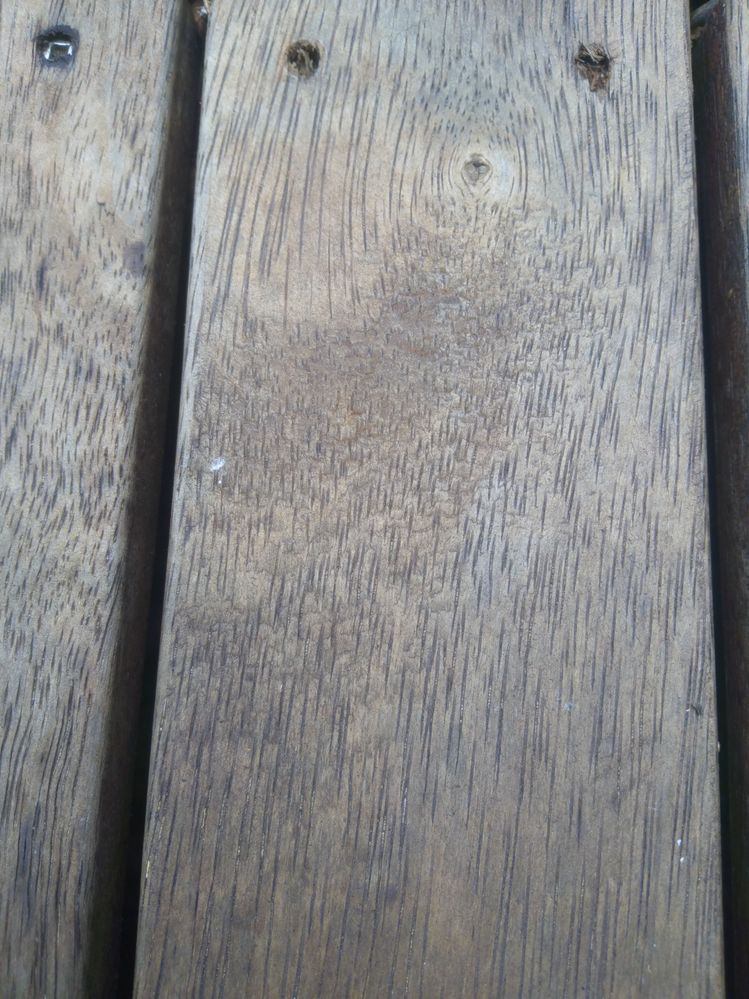

In my opinion, I don't believe that the rough area will compromise the longevity of the plank. I've included an image of a similar area from my deck (it's due for a re-oil). I have a few areas like this on the deck. It was built over a year ago, and I can't see any signs of degradation. Prior to your next oiling, you might like to give the area a light sand with 240-grit sandpaper to smooth it out. Just make sure to sand along the board and not across it. Sanding across it might introduce scratch marks.
If you are concerned about the board, I'd be more than happy to facilitate an exchange of it for you.
