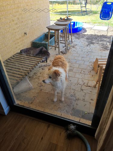

We are updating and extending our alfresco by building a deck. We have a pretty good idea with how to deck on the grass but we're struggling to get a definite answer on how to deck under the existing patio (which has pavers, no concrete slab).
So, do we need to remove the pavers and treat the substrate process the same as we would on the grass??
Or if the surface of the pavers is even and solid, can we treat it like a concrete slab??
Any and all advice and tips are welcome.
Area in question, below.

1. There's only about 8cm clearance from the pavers to the entry.
2. Pooling does occur

Hi @291621,
80mm would typically be considered too small a height to build a deck within, requiring you to remove the paving. Normally, you'd have 90 x 45mm joists with 19mm decking on top, which would require 109mm, even if the joists were sitting on the pavers, which isn't great. Some of our members have gone with turning the 90 x 45mm of its face so it's only 45mm thick. That would be 64mm in total height, leaving 16mm under your joists.
If water pools on the paving, I'd suggest removing it and installing adequate drainage for that area. The last thing you want is pooling water inside a low-level deck frame. Any standing water will send humidity levels through the roof and lead to the early onset of decay. You'd then treat the area like the grassed area and concrete in your posts.
