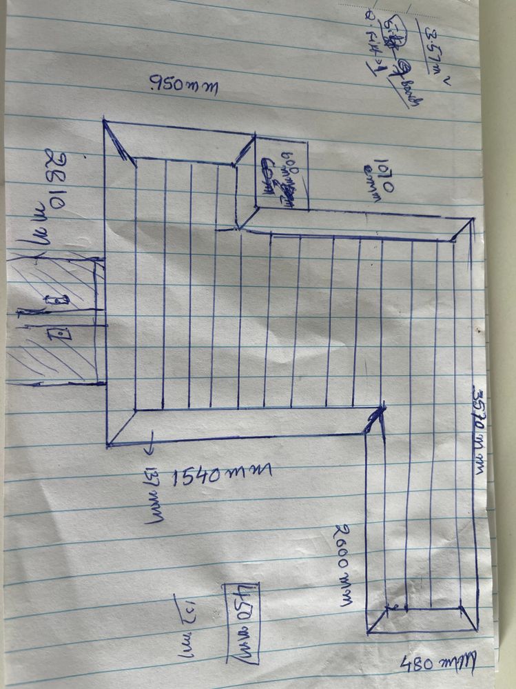

I’m planning to do my self decking at front of house.i need help for purchase materials and step by step instructions.

Nice sketch you have there, Looks like you may have an idea of the type of timber or composite you want to use?
A couple of things would help in figuring out what you might need, the height of the ground to the height that you want the deck to be. A few pictures of the overall area and anything specific you may be unsure of would help.
That 480mm section is meantto be walke don or for some other idea?
Will wait for some pics and then might be able to come up with some ideas. :smile:

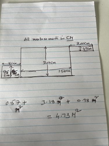

Hello  Eric,
Good morning, attached is image for total dimensions and total squares.
 Main Area 204 CM X 156 Cm
Left Side : 60 CM X 95 CM
Right Side : 200CM X 49 Cm
Can you also list all other accessories needed to complete this project end to end? If possible, include item codes for ordering, such as screws, concrete Dyma bolts, etc.
Re: Low level concrete decking with composite material
Hello @GuptaG
Thank you for posting the measurements of your deck. If the total area is 4.73m2 and you are using Ekodeck with a width of 137mm. Your next step is to divide the area with the width of the decking panel. This will give you a total of 34.52 linear meters. Since you are using 5.4m boards you divide the linear meters by the board length giving you 6.39 board lengths. I propose rounding it off to seven just to be safe.
